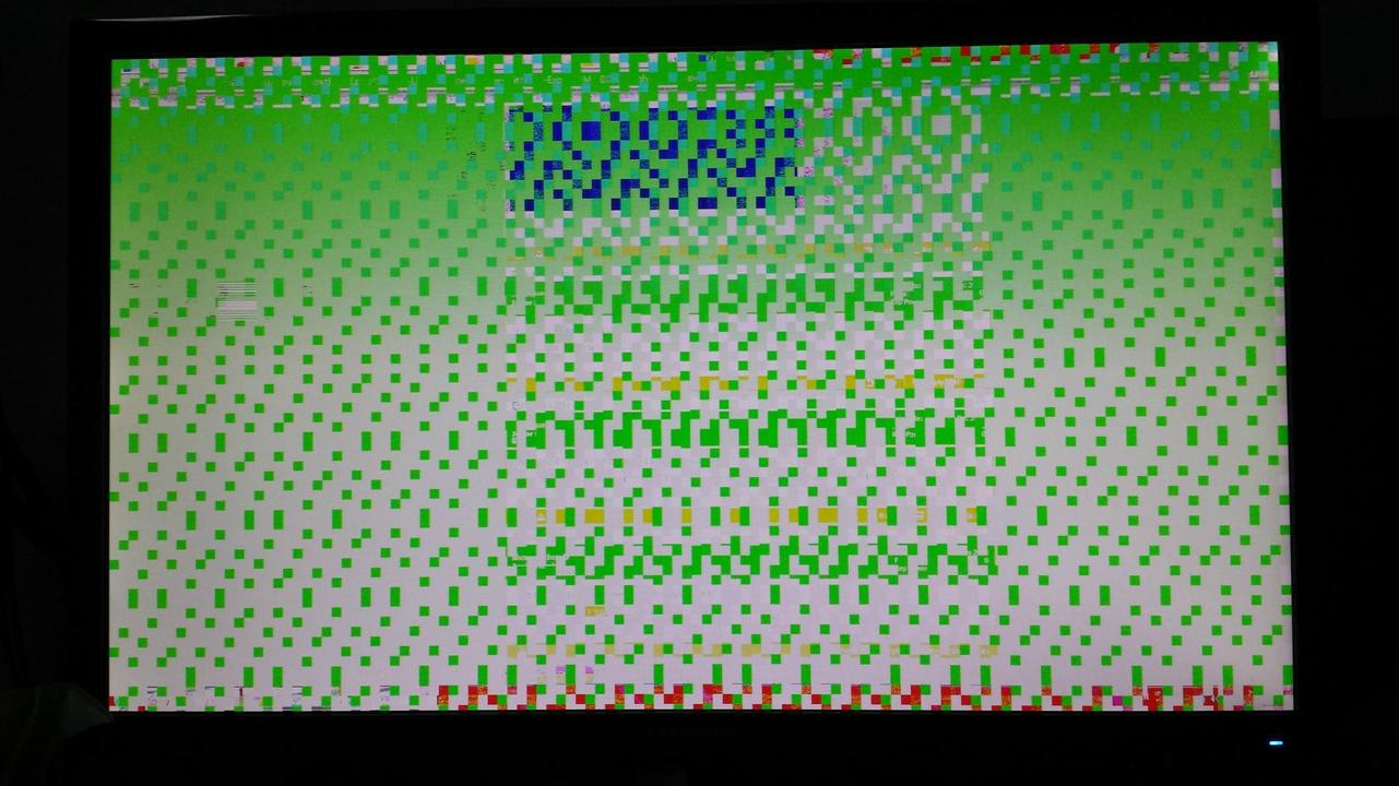

1.I previously used the RAM and GPU on another build (X99) which was aborted due to the motherboard likely being deffective. In this build I observed no output whatsoever onto my TV but this time the TV registers a 50Hz input and shows a technicolour mess on my screen, similar to the below taken from another forum and used for ilustrative purposes.
2.Without the GPU installed, and with both RAM sticks installed the motheboard shows a DRAM error light and by removing one the error light dissapears with only one stick; suggesting one of my RAM sticks is faulty. However, when the GPU is installed the DRAM error light remains on regardless of which RAM stick is installed in the system.

Your motherboard says it's "Ryzen 3000 ready", however that doesn't necessarily mean it doesn't need a BIOS update,  as it contradictory says in the description "Gen 1 & Gen 2 Ryzen support"
You could try updating the BIOS - if you have a compatible CPU or try a repair shop  which doesn't sound like a bad idea either,  especially if you don't have a compatible CPU.
Though it's still possible Ryzen 3000 ready actually means it's compatible, I had a B450 Tomahawk Max which said that and which was actually compatible and didn't need a BIOS update for Ryzen 3000.
(btw I don't recommend this board regardless, because it kept crashing my PC randomly,  which I suppose was an issue with the RAM or similar)
RAM works no issues on my B350M mortar however,  no crashes either unless I OC my GPU too much lol.
Well it sucks your PC doesn't boot,  hope you can get it fixed, a BIOS update shouldn't be too expensive I guess.
