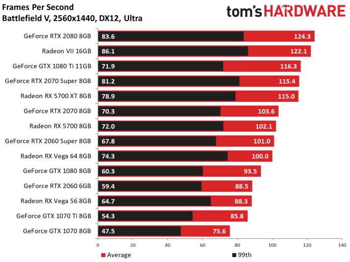

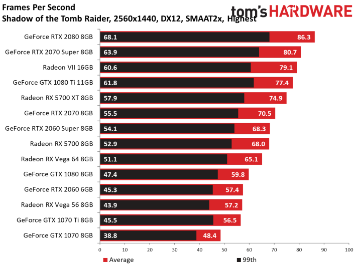

What frame rate are you looking to achieve?  Do you have a couple monitors in mind?
Here is a comparison chart of the RX 5700 XT in BF5 and Tomb Raider.
Hey thank you for your prompt response. I am looking at the msi 100 hz 3440 x 1440 p monitor. But I've been looking online and started to feel sceptical about the actual performance. Im aiming to game at close to the monitor's refresh rate of 100hz. I don't mind adjusting the settings. But im trying to avoid having to sacrifice too much video quality for resolution

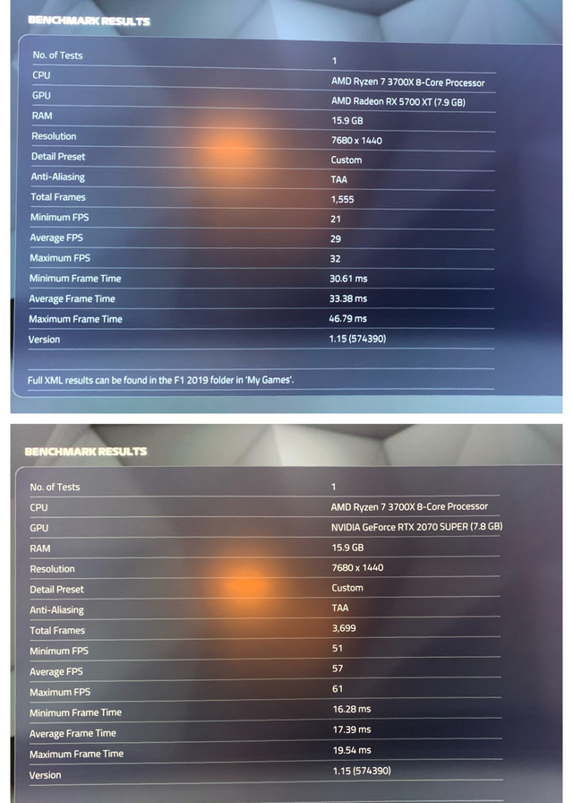

One thing to be aware of is that the RX5700XT dislikes high resolutions, the higher you get the more performance it loses so it might be valid to consider the RTX 2070 Super instead.
On 2560x1440p is about 6% faster on average than the 5700XT but on 4k it increases to 11% gap... just something to be wary of... on "gigantic" resolutions the difference gets insane:
Not really sure why Navi dislikes high resolutions so much.
