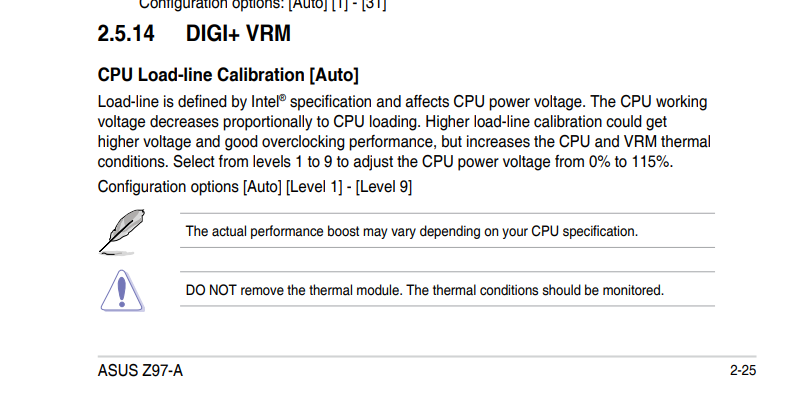

Do you know where this is done on the Asus Z97A?  I do not see an option for LLC.

I took a quick look at your motherboard manual. Here's the information for it.

If you said it isn't stable at 1.35 V, it probably won't be stable at 1.3 V. However, if you use LLC, it might be stable at 1.3 V.
Note that load-line is there as a protection against overvoltage with voltage spikes when your CPU is under load. As a result, your voltage decreases when your CPU is under load, and this can result in instability when your CPU is under load. You can set LLC so you can get higher load voltages, but obviously you don't want to set it too high. For this particular board, if you need more than level 5 LLC to be stable, then it's probably not worth it.

I tried applying level 9 LLC and setting the other options to extreme and still could not get stable 4.7 at 1.35.  I guess my cpu can only do 4.6 even if it is at low voltage.  thanks anyways.
