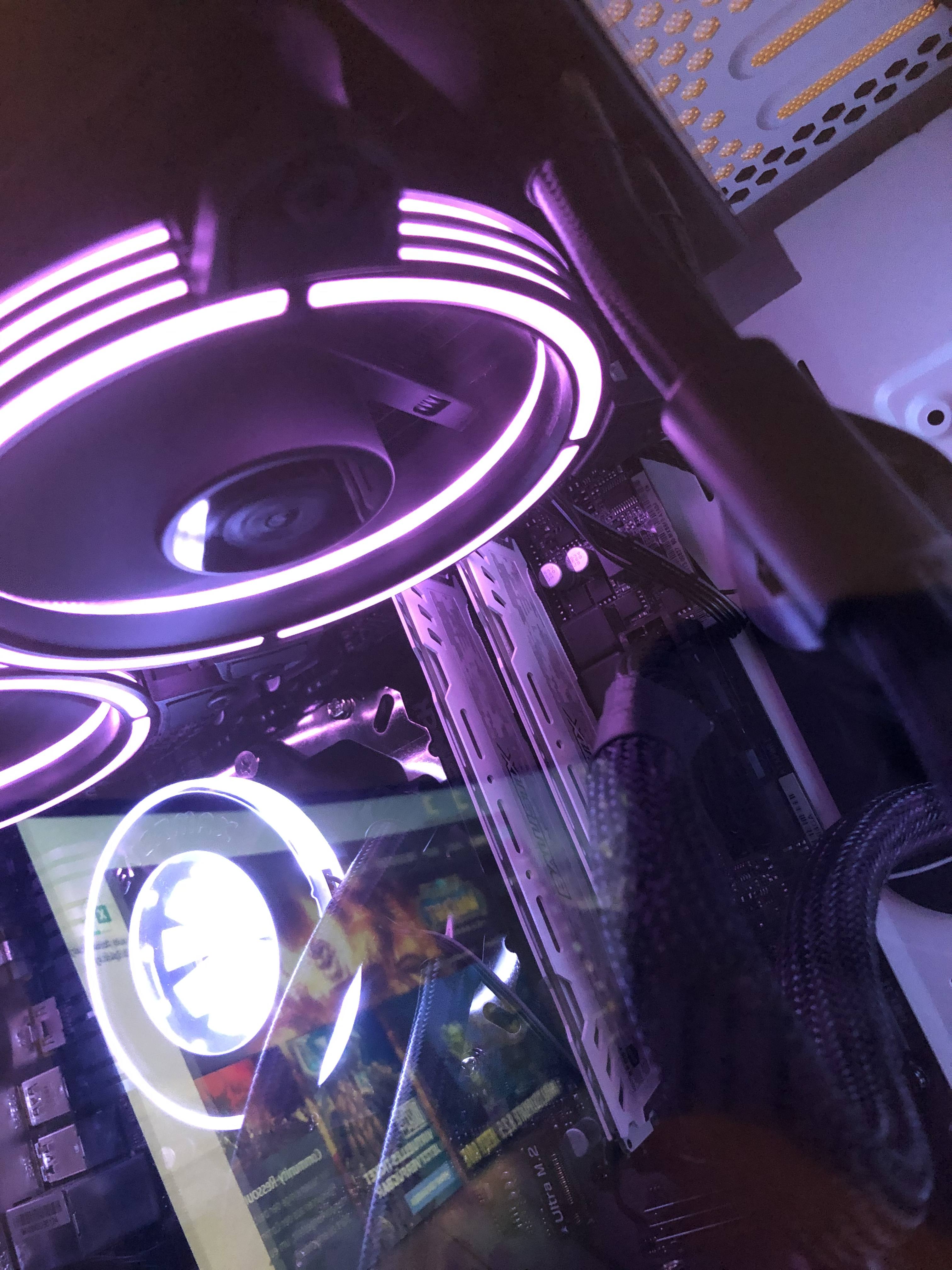

Hey y‘all,
I just upgraded to a Corsair iCue 465 RGB case and an Enermax Liqfusion 240mm RGB aio. Beside that, I am running an ASRock B450m Pro 4  mAtx board and low profile ballistix RAM sticks.
So I received the parts on Monday and started the building immediately. Installing the parts in the new case were very easy. I then came to the point of installing the aio, which was my first one ever to install.

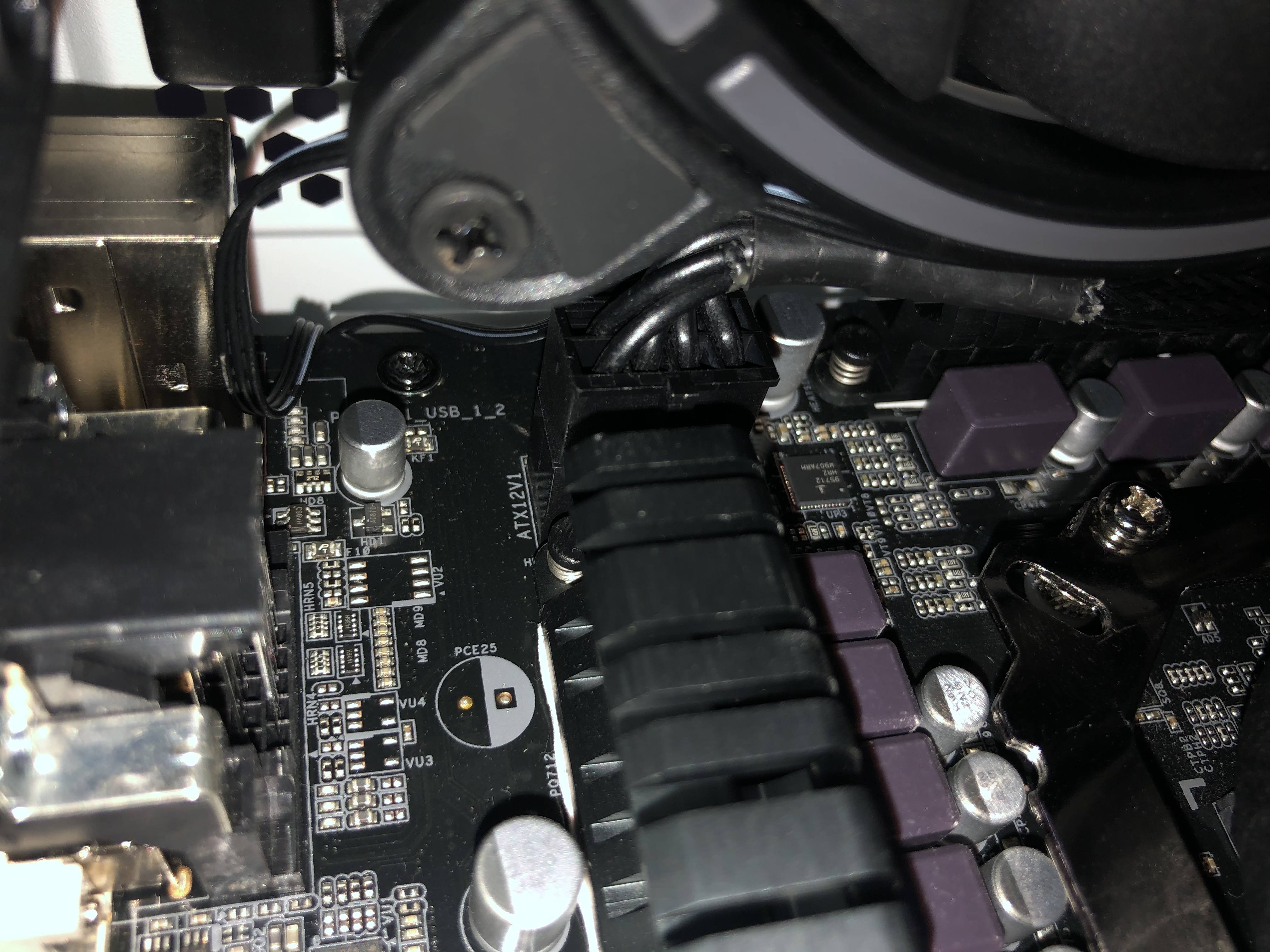

I had a really hard time to fit the radiator with fans into the top of the case. Especially the CPU power connector were in the way which I then had to bend it out of the way. Luckily, my RAM is low profile, which made things easy. Also, my VMR cooler would not have been allowed to be any bigger or it would have blocked my radiator.
Coming to my question:
which dimensions of which parts do you have to consider, planning to buy and install an aio? I thought you just had to have a looks, if your case can fit the radiator. But obviously you also have to look on the mainboard and RAM sticks. How do you know if all parts play together? I am afraid to upgrade my mainboard or RAM (with probably higher profile) and then not being able to install my aio again. So, what do you have to consider? Would it help to get an ATX instead of mAtx board so there is more space between the parts?
thanks!
