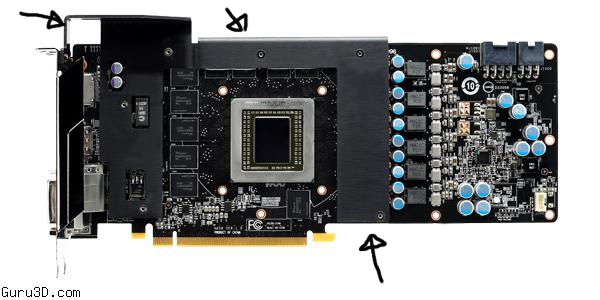

EDIT: When i say Metal thingy i mean this. The r9 only got this on the vrms, so they are not in contact with the heatsink at all:
I doubt that would fit. We can see from this naked PCB of the MSI 270X GAMING that the capacitors aren't in the same spot, so that heatspreader will probably be phyiscally blocked.
Yeh nah that is a picture of how a r9 290 looks. I didnt manage to find a picture of a r9 270x in time so i just took one who looked close. This is how it really looks along with the rx 480 pcb:
