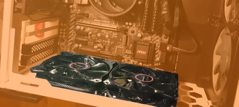

On 10/31/2019 at 3:51 PM, Mark Kaine said:
I may went a little overboard with my case fans :D
Your case airflow seems backwards. It will at least provide fresh airflow to the cpu cooler but it's unfiltered unless you added an aftermarket one that I don't see. At the very least, the fans below the graphics card should be facing the other way since it's currently fighting with the graphics card fans.
  Hide contents
Pretty sure this is wrong,  my case is designed differently than most,  there is a dust filter at the bottom,  which means it's an intake, and while I agree it seems weird to put the airflow directly onto the GPU,  I've tested this,  the GPU is about 3C cooler with this setup than simply without bottom intake fans.
Interestingly my case (the inwin 301) is supposed to have "bad airflow"  but this is mostly due to the testers not grasping the concept,  and like you suggest,  actually set up the fans the wrong way, or not at all.
It's also funny I'm seeing overheating Ryzen 3600 left and right,  yet mine is super cool with stock cooler at ~35 idle and the max under load I got it so far was like 63C.
And it was the same for my 2200G
And my 1060 also doesn't get overly hot (73C max,  but usually it's more like 68/69C in most games)
And also the fans aren't fighting with other fans, the bottom fans are pushing fresh air towards the GPU intake as you can see in the picture you posted yourself, and thus help to keep the system cooler ("whooping" 3C on average in my rather extensive tests with various benchmarks and games)
The fans on the psu shroud in the photo are acting as exhaust and not intake. The photo shows them blowing air downwards.
Actually the PSU airflow isn't shown at all in this picture?
However, the PSU is indeed not ideal in this setup as it's mounted on the top (not sure if you've noticed?), but we were talking about the GPU now and that works very well,  if awkward... That's also why I wanted to be able to control the bottom intake fans because I don't want them to blow air constantly towards the GPU when it's idling...
Like I said,  3C difference with compared to without 2 bottom intake fans (currently I have only 1 installed sadly due to the circumstances of my mobo not supporting DC control on the third fan header)
I'm just saying,  there *is* generally a huge misconception on how this case works and as such it didn't really get favourable reviews, it should have tho,  it's an excellent case,  high quality,  sturdy and good airflow.
I'm not referring to the psu fan. I made a mistake thinking there was a psu shroud when it was just the bottom of the case.
These are the fans at the bottom.
They are blowing downwards. Flip them so they're blowing in the same direction as the graphics card fans.
Oh.  But they don't!?
You would be definitely right if that was the case,  but they don't,  they blow upwards. :)
How are you checking for this? Have you tried removing one and using it outside of the case?
Almost all case fans exhaust from the side with the frame and intake from the other.
The fan blade design also indicates that it's blowing towards the frame.
