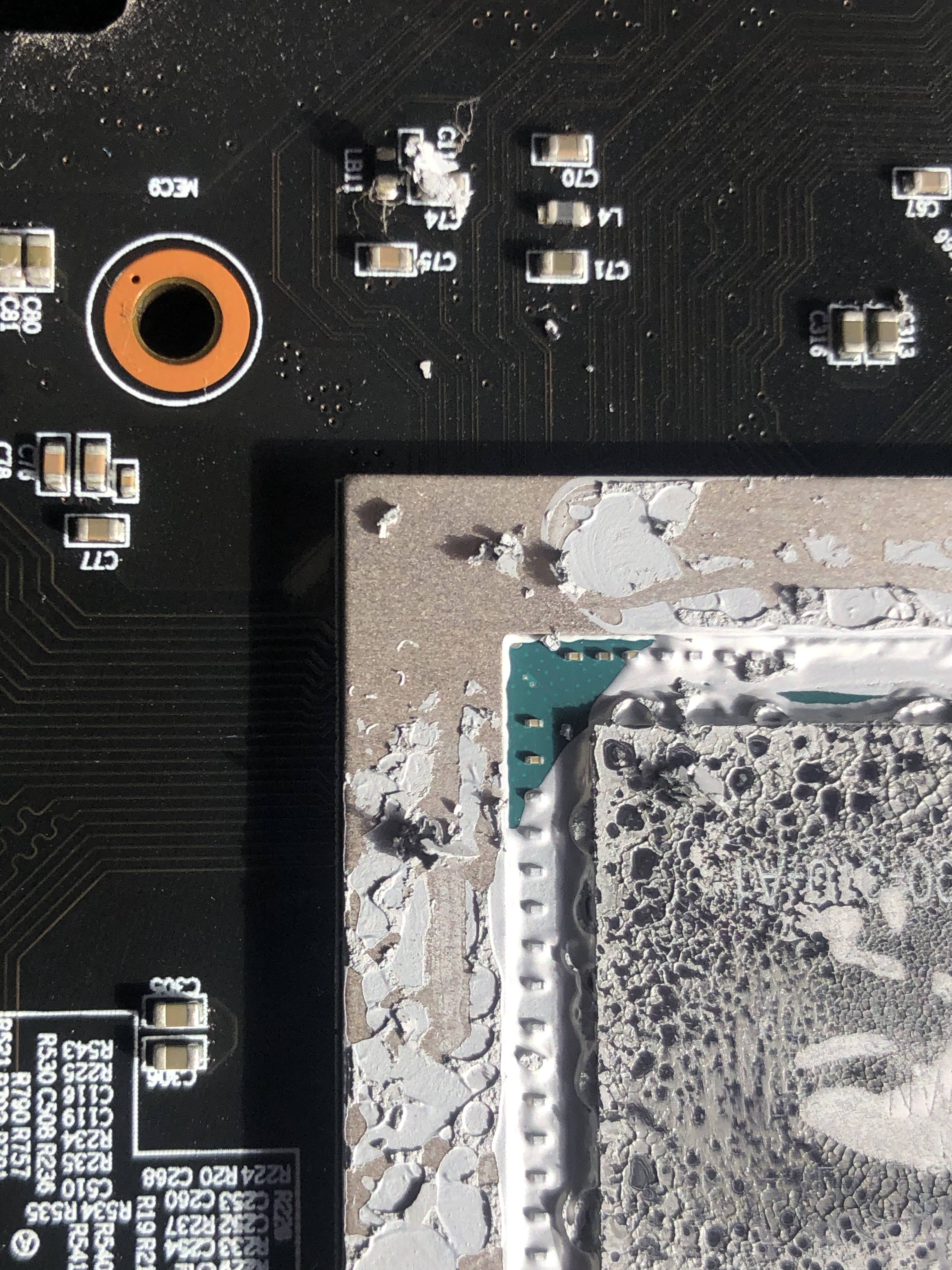

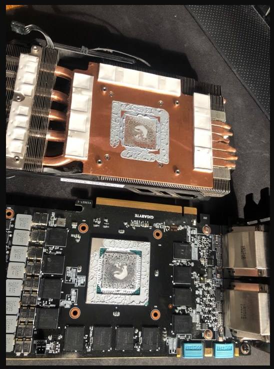

I took the cooler off and that's what i saw, i don't think that looks as it should but maybe that's the way they did it.
Nothing seems to be burned or damaged in other visible way.

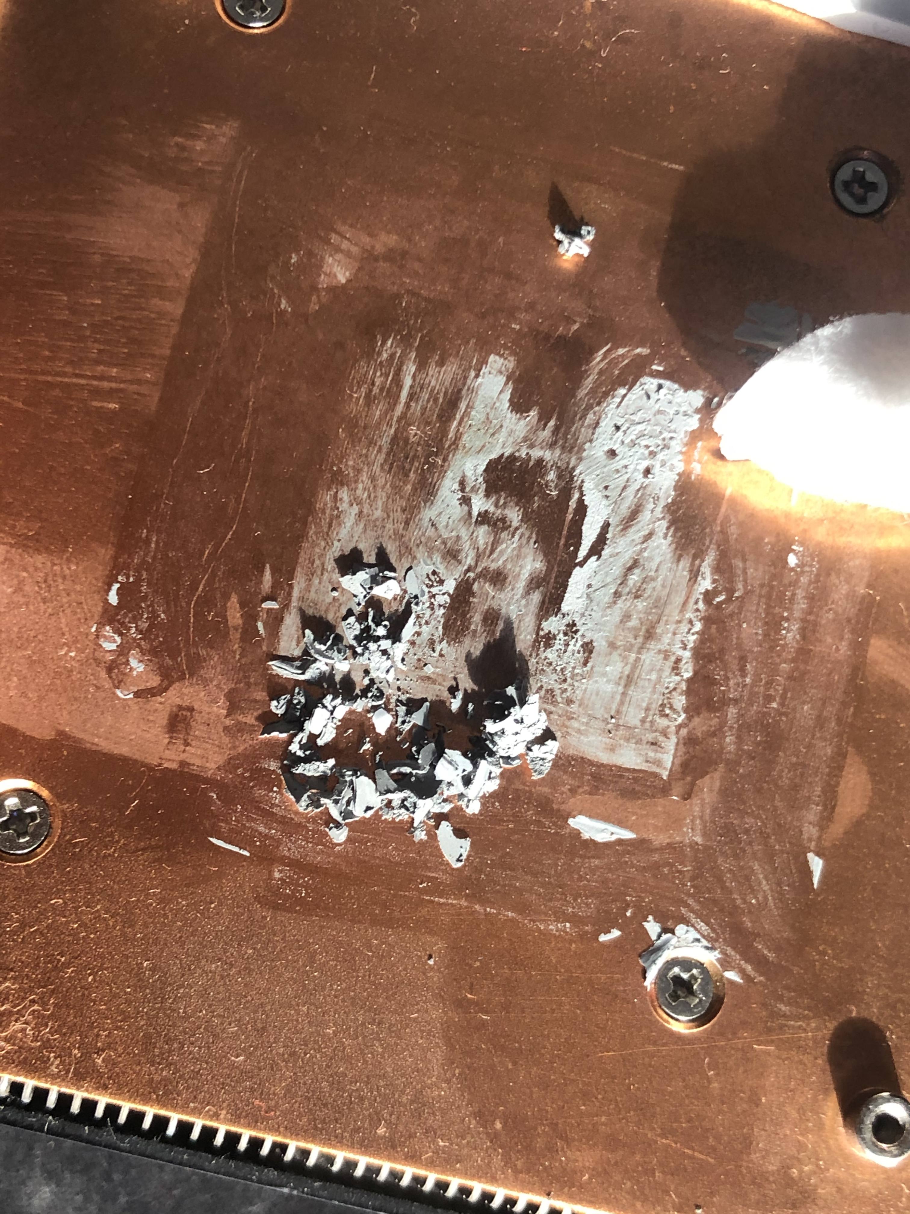

I scraped the thermal paste with flat piece of plastic and it is super dry. Thermal paste on the square piece around chip is the driest paste i ever saw. Thermal paste on the chip was dry too but it was “more” like a liquid but very far from good consistency of a thermal paste

Yesterday i saw something interesting. When i was inspecting PCB at the angle i saw a rainbow-ish area. In center of this area there are 4 memory chips so after a few minutes i came up with conclusion.
This area looks very overheated and i think it happened because of enormous power draw so i think there must be some short or burned transistor, capacitor, resistor.....
I have checked fuses and they are not damaged. I will check more things when my lab power supply will and i need to ask some friends to borrow thermal camera to see what is causing problem.
