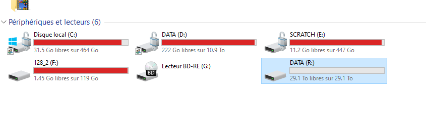

8 minutes ago, Kilrah said:
Just added a bit of fresh air...
29TB? ?
My gaming system local storage. I haven't mapped network stuff yet. Video recordings go on G, which I partially emptied. In case anyone wonders why I have 1TB HDs and not bigger, they're 2.5" for lower noise than 3.5" ones.
