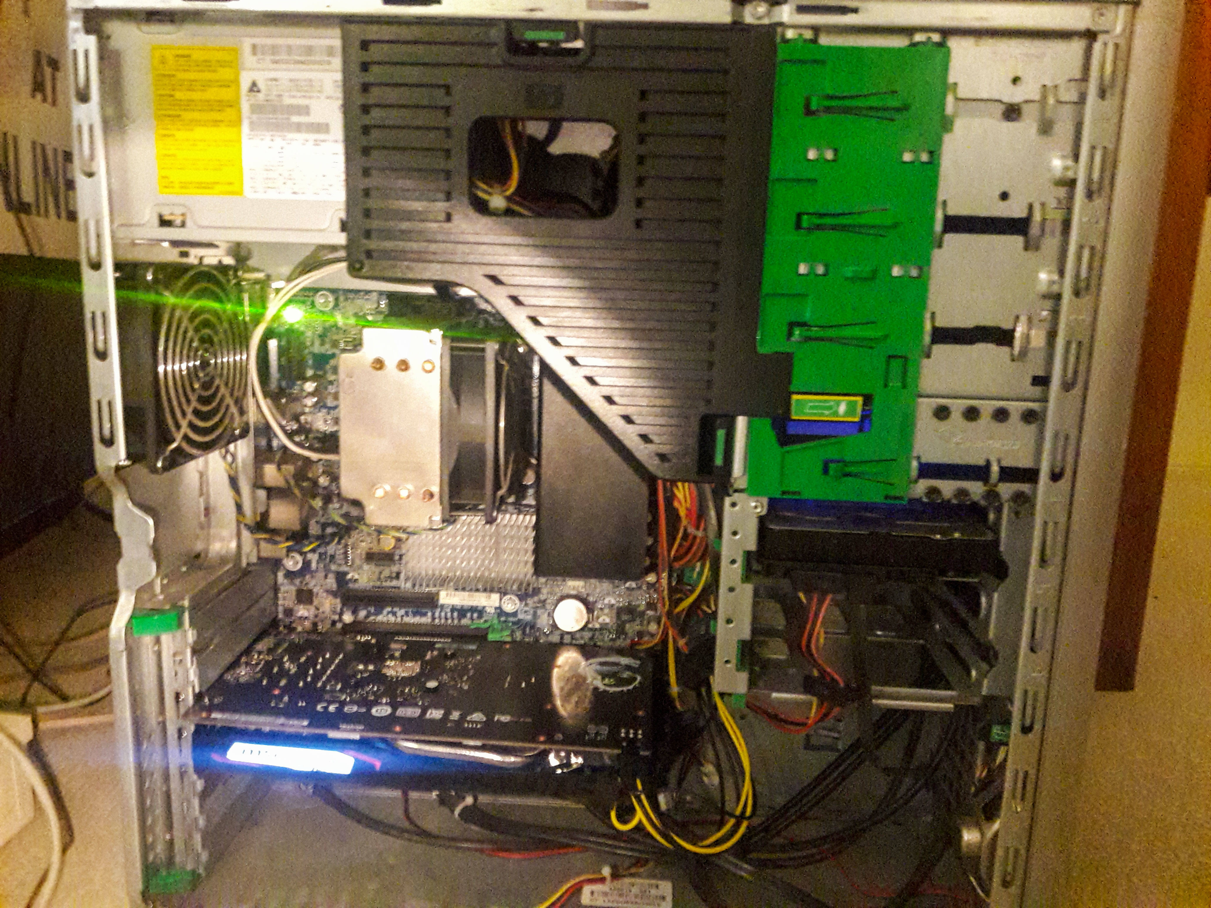

By the way I am getting power to the card by adapter from one of the plugs for a hard drive. Sata to 6 pin adapter; the power output works out to be used in cards.   It is amazing if you spend some time researching things what you can come up with to get things running on a computer.

This project is finished I like the results.  I had to say goodbye to Windows 7 pro and upgrade to Windows 10 pro so I could download uptodate drivers.  The 1650 works well in the Z400 for rendering and modeling work should be able to keep the Z400 for a few years more.  I am glad to retire the FX 1700 Quadro it was a good graphic card for its' day but really out of date nowadays.  Also I had to adapt a the 6 pin power to the power output to sata power.   The card is a MSI 1650 Gaming Card.
Please overlook the 2006 factory cable management from HP.  This is the way they came back then.  Z400-VideoCard-Update-web.thumb.jpg.fc7aa0f4e0b8650bb4073d6d3e372beb.jpg
