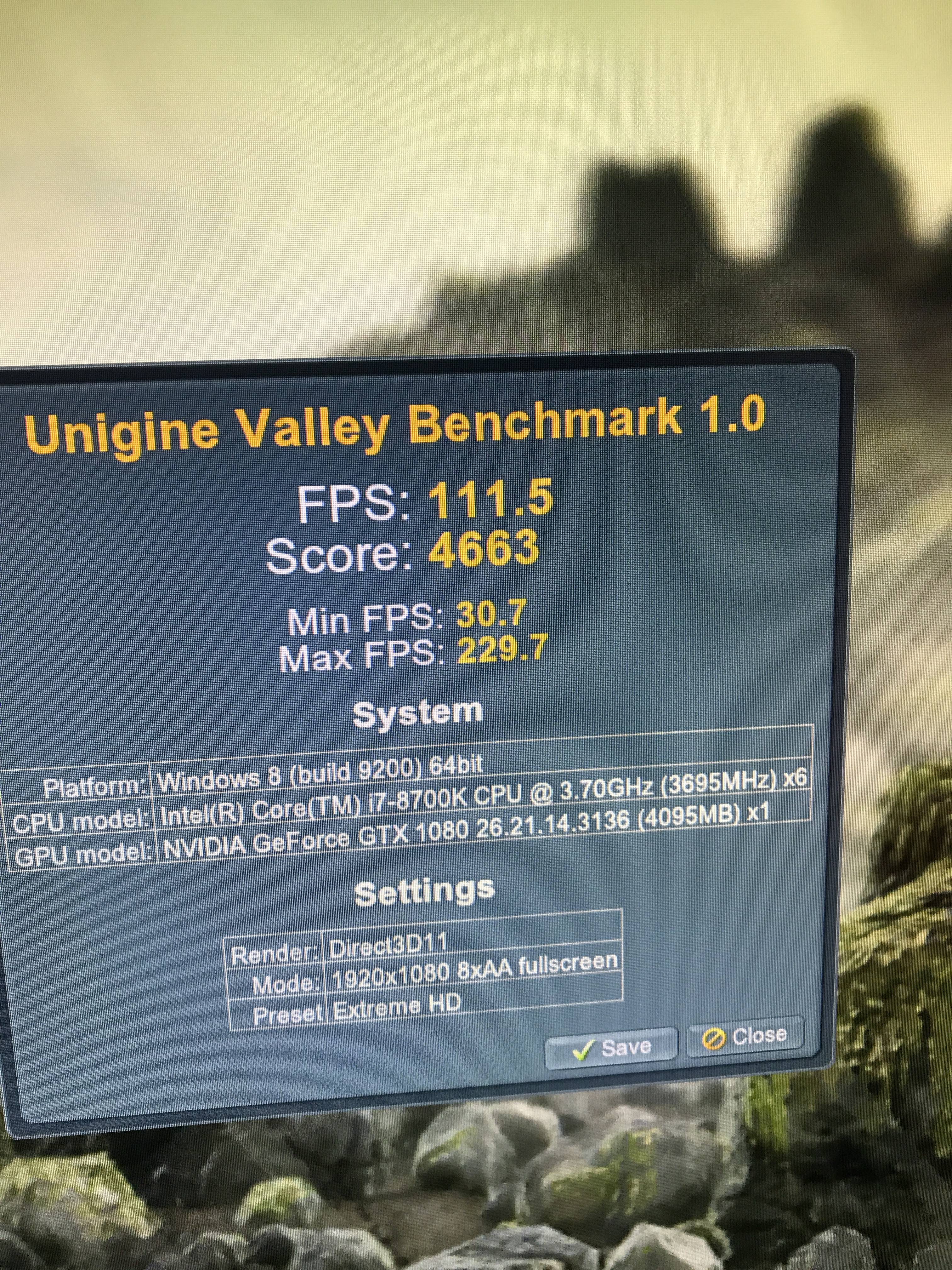

I dont have any results on my phone for heaven. Only valley. Have the results of a 1080, 1060-6gb and 3gb for heaven on the saved on pc though.
78 FPS is an improvement over 71FPS you did previously, don't think you will get 100FPS average with a 1070

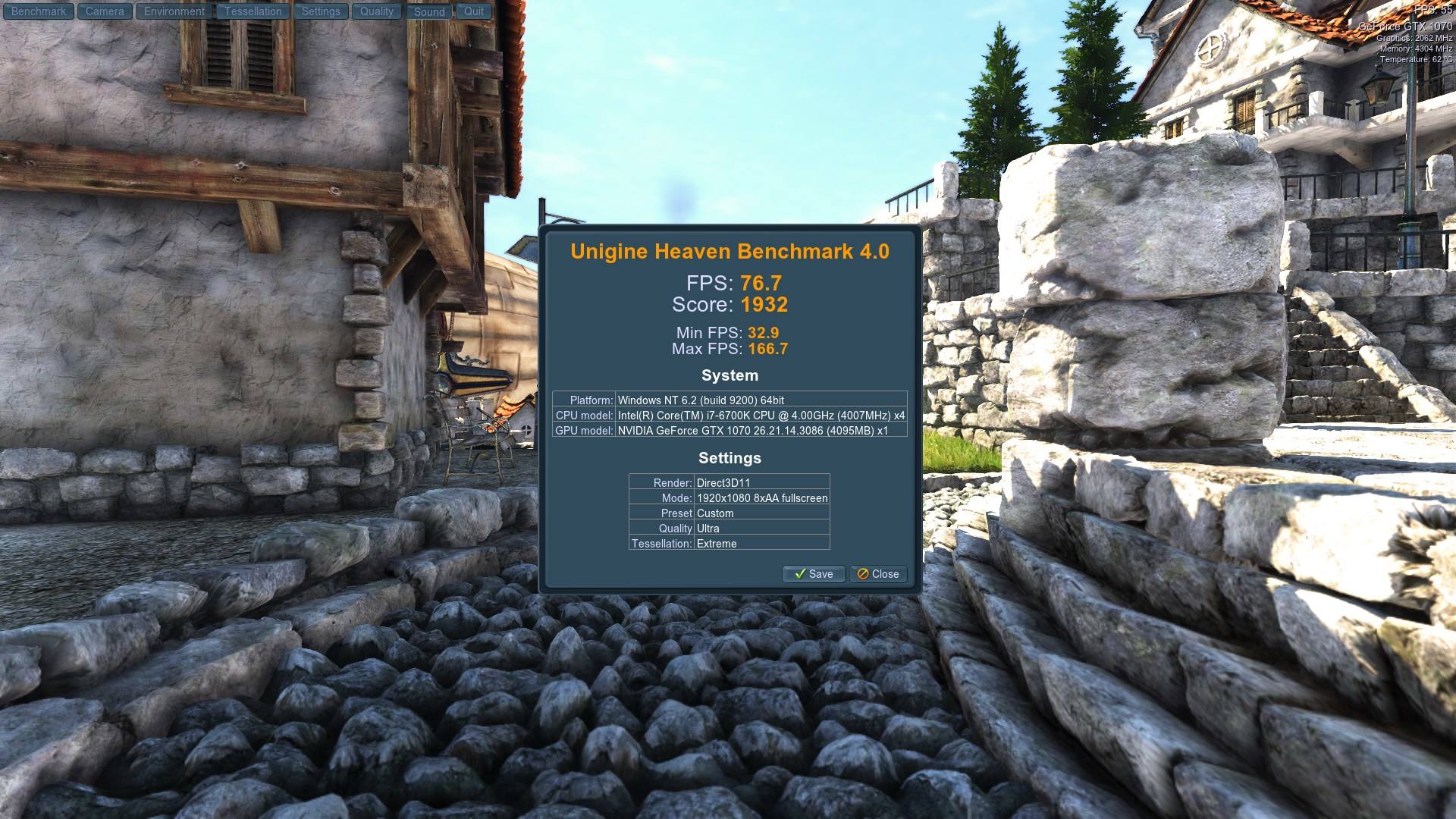

I know I had an identical problem few months ago, but can't recall how i fixed it. Maybe removed GPU-Z, but yeah, can't say for sure.
Only have a Heaven screenshot to prove it:
 Cleaning old drivers and monitoring GPU frequencies can't harm though.
