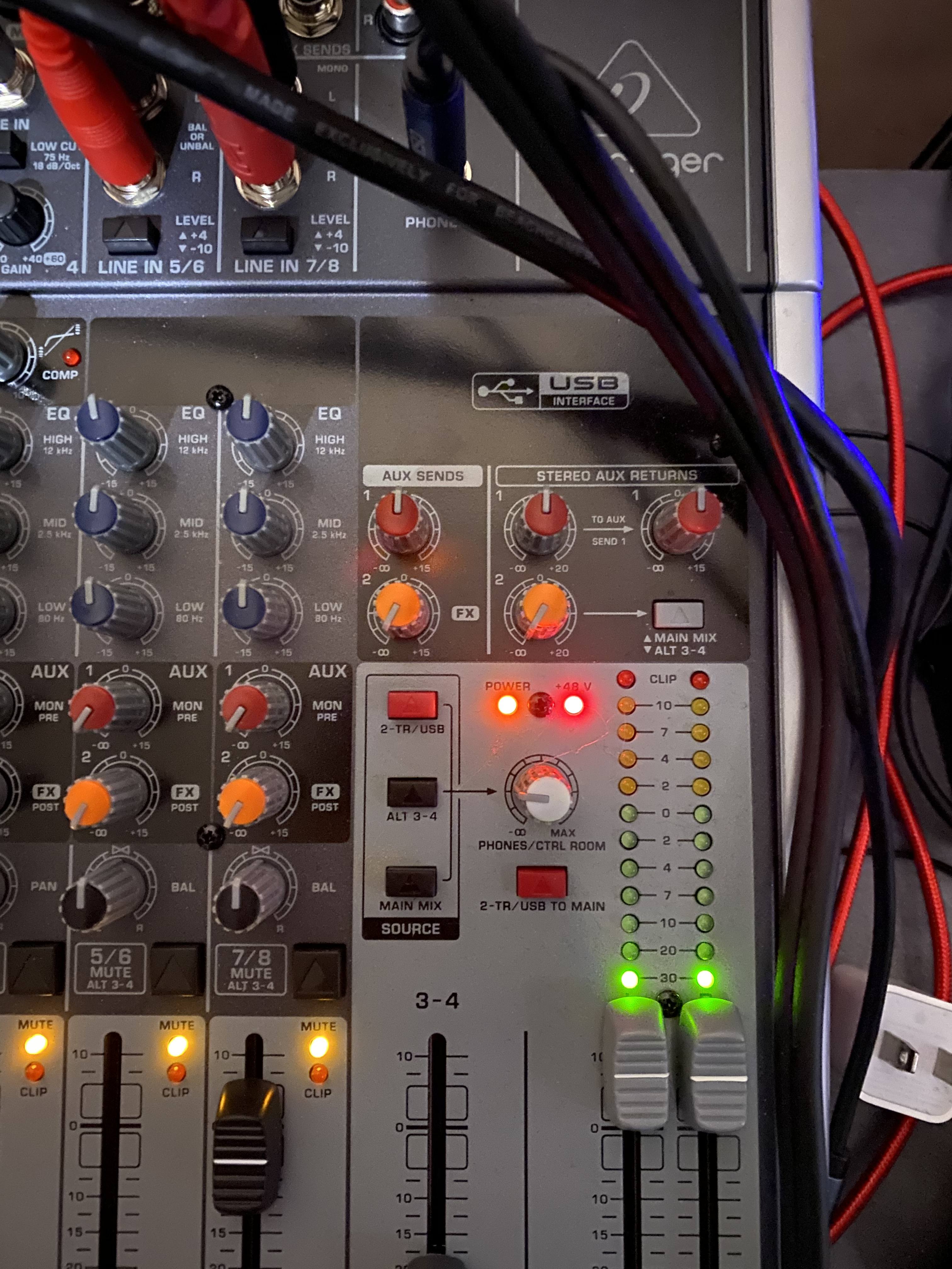

So far after doing what you told me i can hear myself very low when sending a message via xbox live but there also alot of static. Im going to attach a photo of the way my mixer is setup.
Looks like you have the compressor turned up for your mic channel. Turn that down to near zero and middle out your eq to test.
In the photo you have your main mix faders at negative infinity. When using your mic, have them turned up to 0.
From here, can you label everything? I'm not quite sure what's where.

Assuming everything is plugged in just like the video, it looks like you need the FX send (i was wrong, I thought this board had audio effects, it doesn't so ignore my previous comment about that). But it looks like you need the FX send on only channel one, where your mic is plugged into, to be turned up. Start with it in the middle perhaps and test from there.

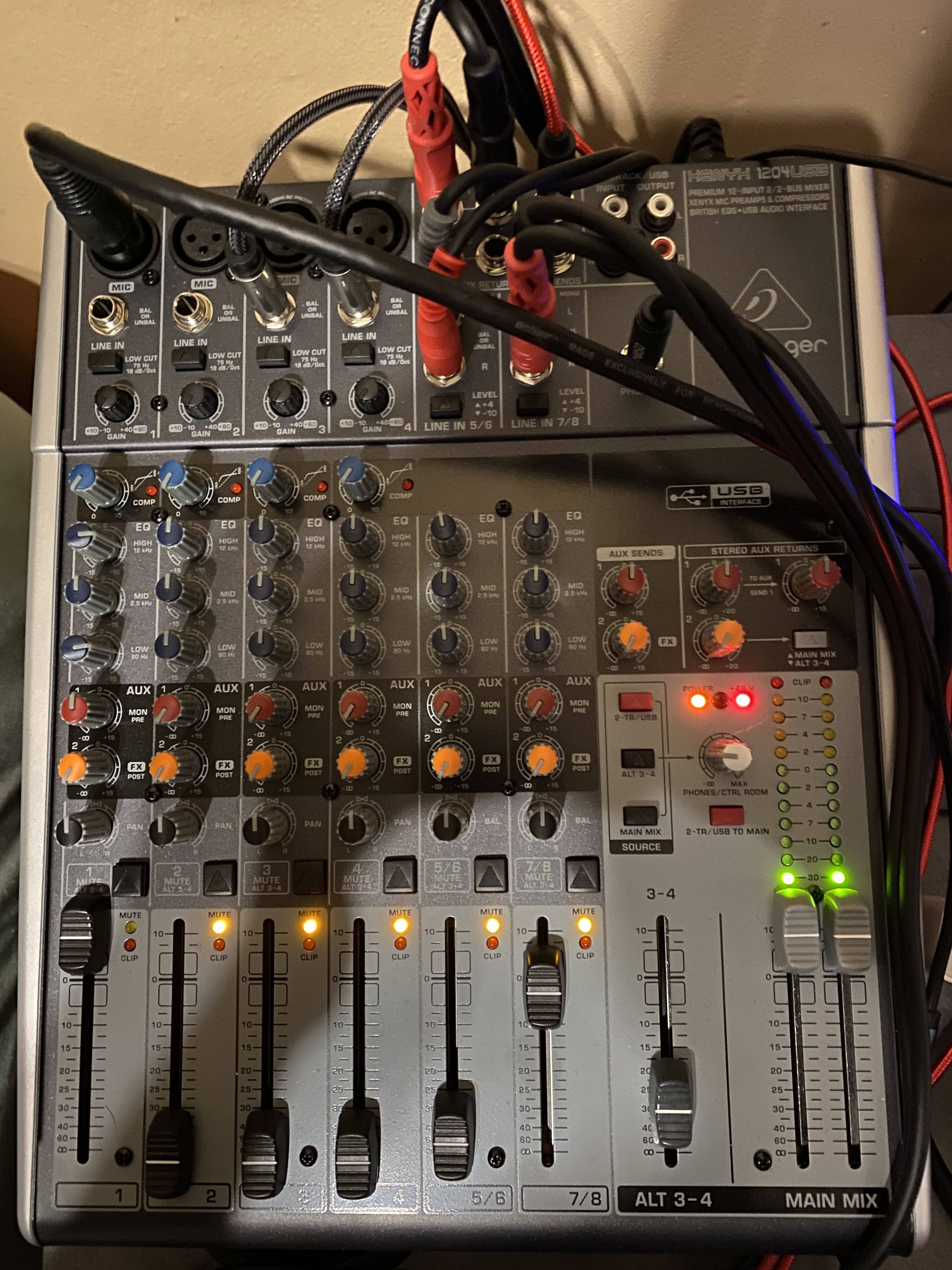

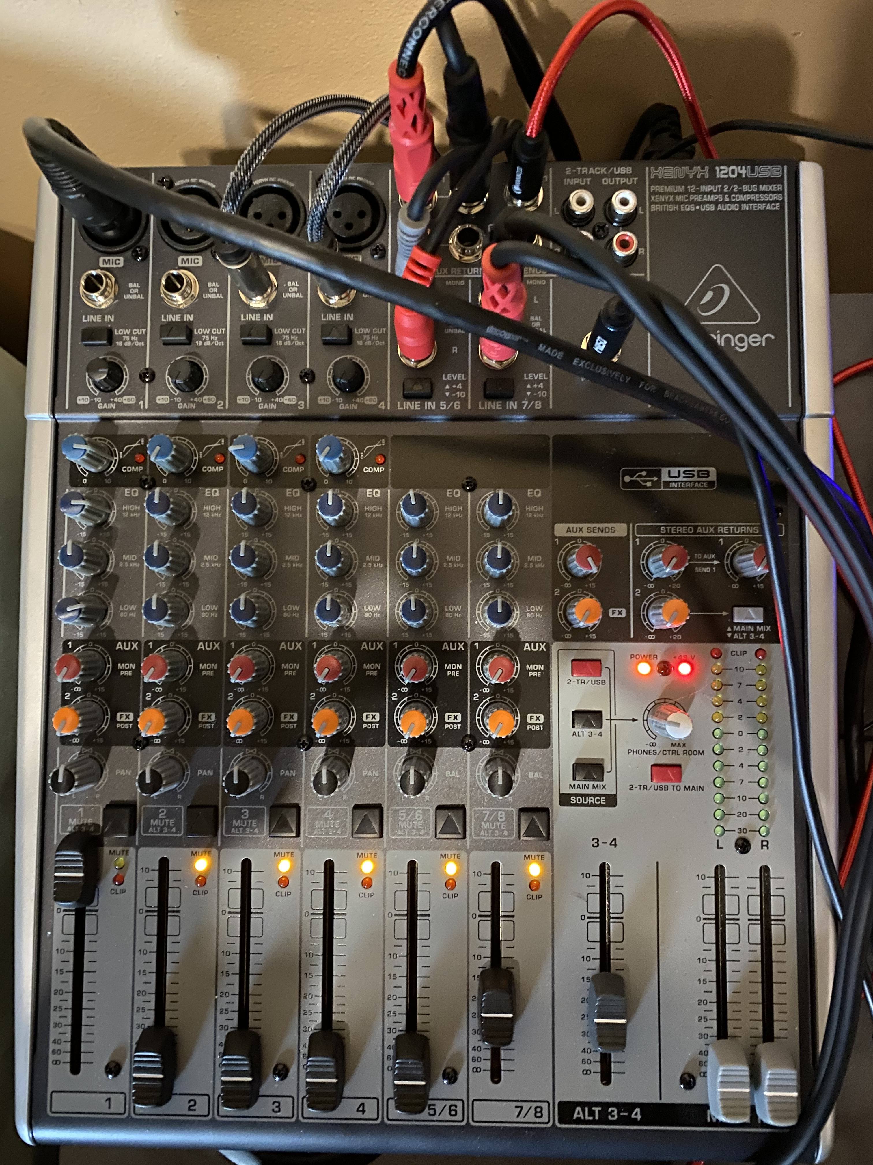

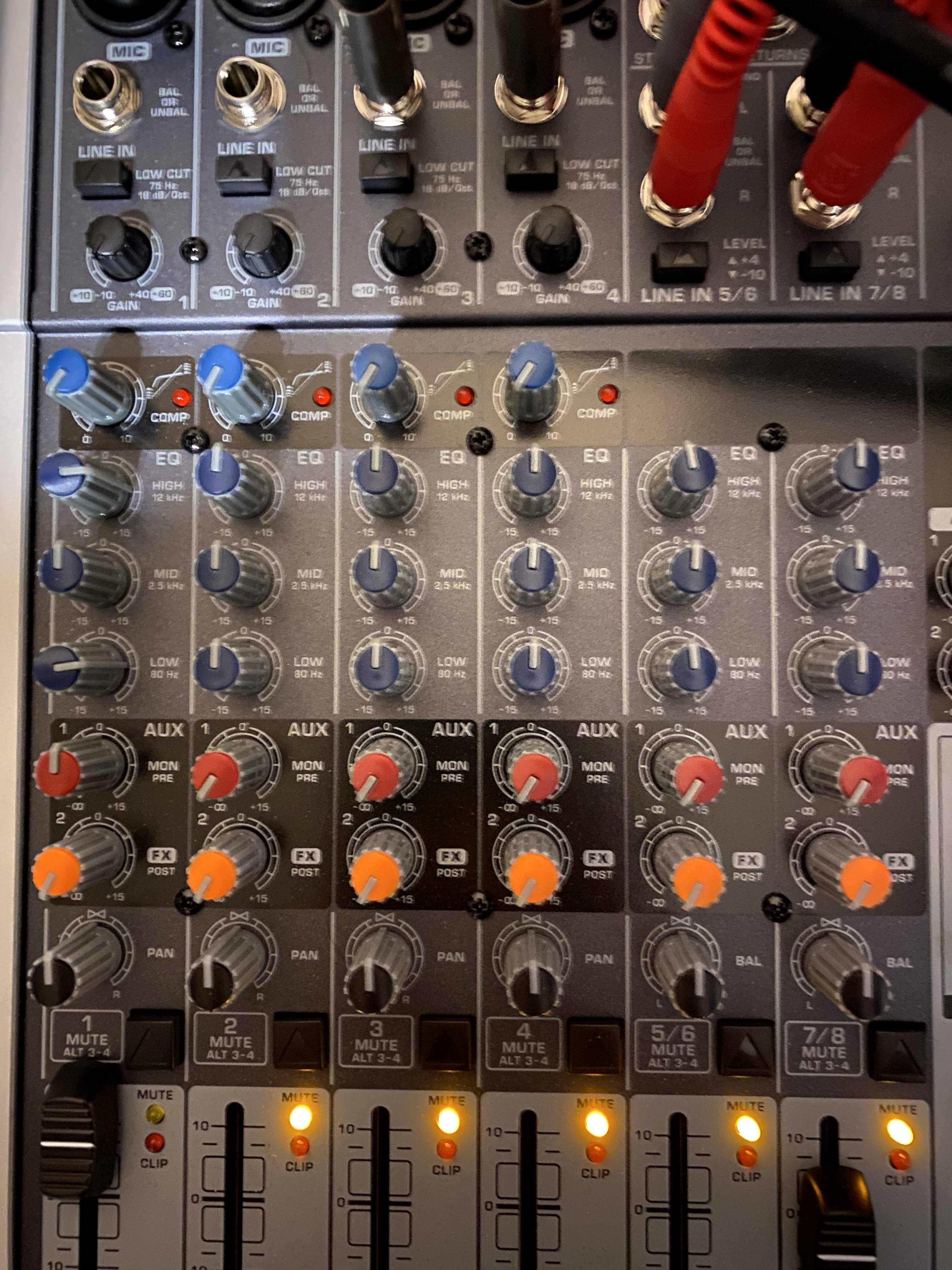

Sorry for the late reply. I’ve got it to work my buddy can hear me over on Xbox although he still hears a low static any clue on how to fix that. I’m going to attach photos I took of the way I have the mixer setup and working. Also I turned on my stream and recorded a bit to hear how it sounds my voice is very low I’m assuming that’s something to do with the streamlabs configuration I have to look into?
Level your faders to zero and use your headamp/gain to get higher volumes. Other than the noise with the mic, does everything else work as it should? I don't know anything about Streamlabs, so you may want to create another topic for that once we figure this out.
The noise could either be a ground loop issue, or it could be the sound card on your computer it's plugged into. Especially if it's onboard audio, there's a good chance it's not isolated well enough and your noise comes from whatever sits near, or next to, the onboard audio circuits. You can try a USB sound card like in the demo video to make sure of this.

i just tried recording a message to my friend via xbox live and it sounds fine now im waiting for him to log on and join a party chat so i can see if the static is gone. I picked up the red aux on channel 1 all the way up and i dont hear no more static on the voice message so lets see if that fixed the problem.
