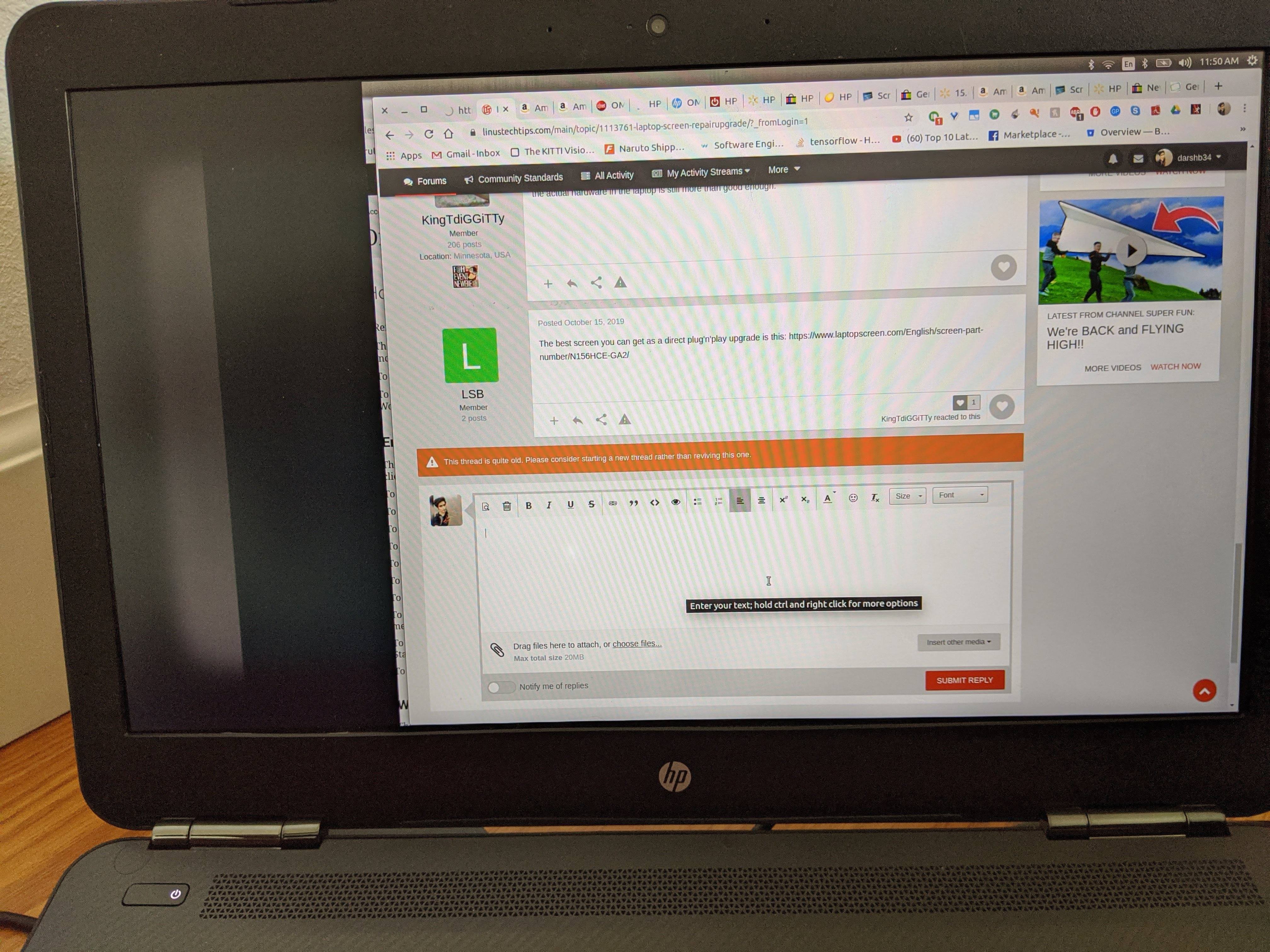

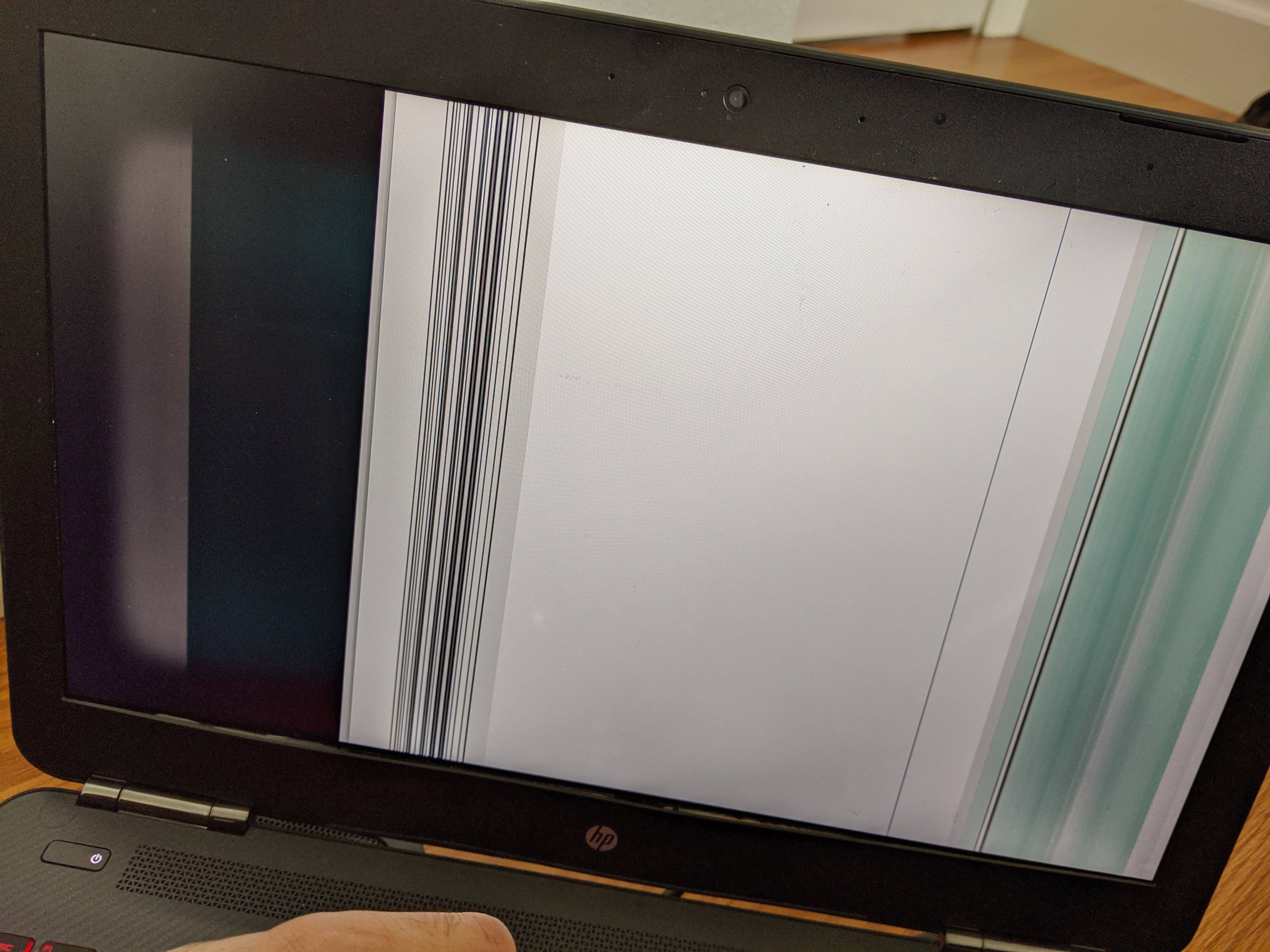

I think the screen was bent somehow. Whenever the screen is bumped it freaks out.

your issue might be flex cable. Can you take picture of the screen during it craps out?
1 minute ago, KingTdiGGiTTy said:
Becuase of camera syncing things It is quit representative
Considering artifacts happen on vertical axis, I would get a new flex cable just to be safe. I am just not sure if this is just a panel issue, I am curios on what others think.

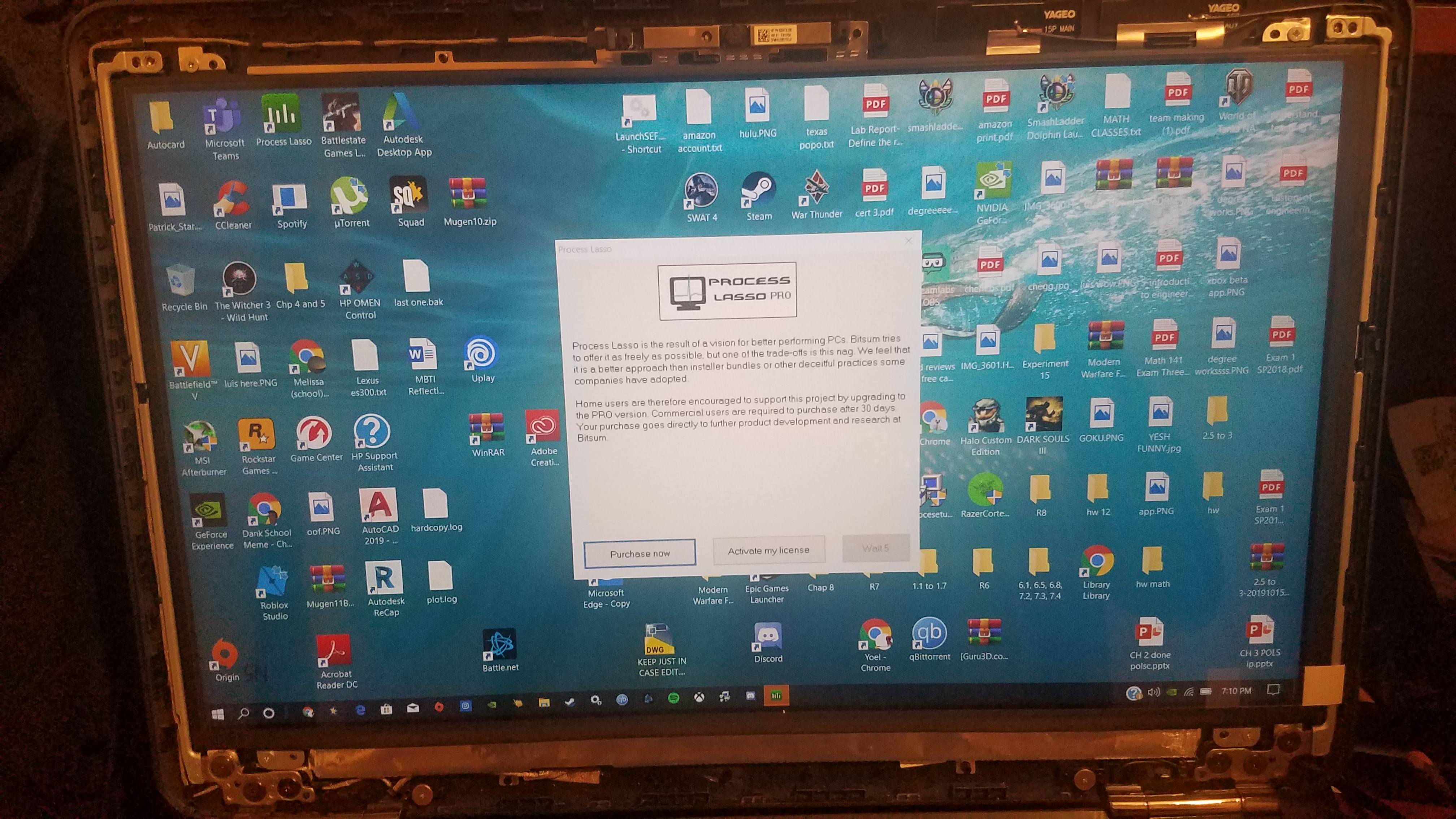

Hey I replaced my display and it worked
This is the 120 hertz version i got on laptop screens
My display cable looked fine so i didnt replace it.
I had lines like yall and sometimes the display would work but its working perfectly after replacing
And yes i need to clean my desktop lmao
Also ill he getting a 20 dollar refund if i create a video on how to replace the display so it would be 60 bucks total for me.
