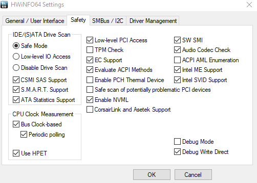

do you have any other software installed like HWInfo or anything? I had issues with my commander pro because of it and you have to turn off the Corsair/Asetek support in the settings of HWInfo.
Yep, i do have hwinfo always running in background however i also had hwinfo back then with default settings and it was working
p.s tried turning hwinfo off... Same
