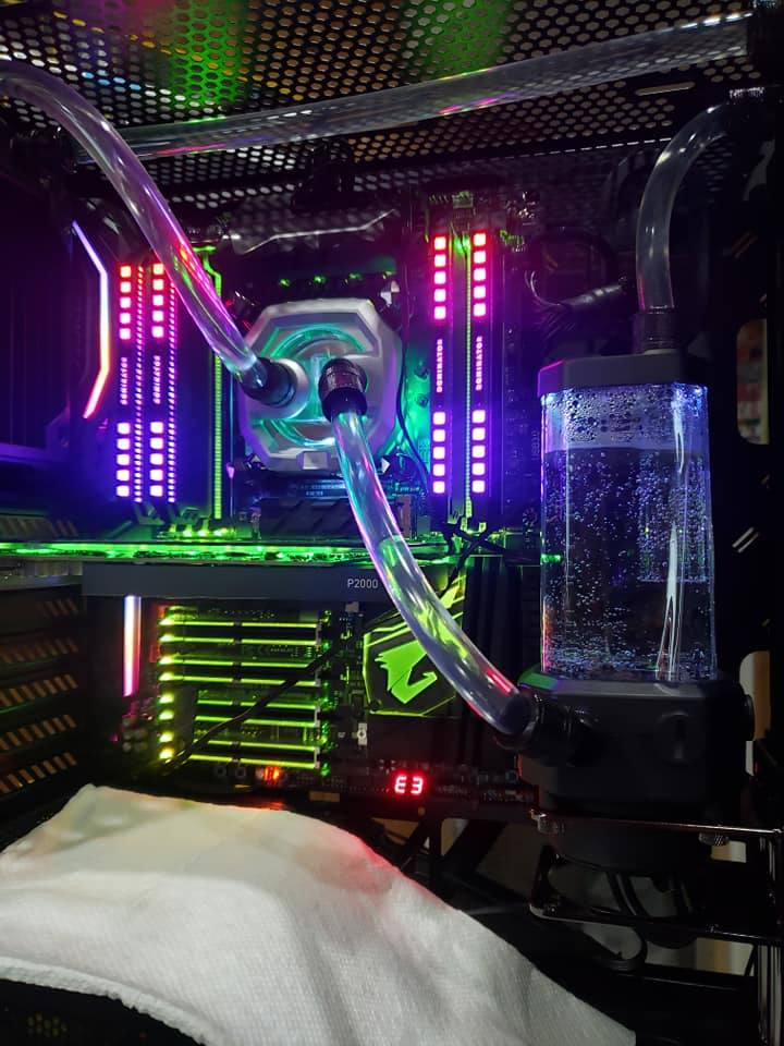

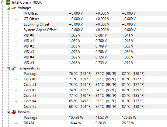

@WoodenMarker
My Cooling System is not complete but I was testing with a 120 + 360 mm radiator without fan.
I will add 1 fan on the 120mm later.
But 2 hours rendering (90-99% CPU usage) shows temp as 87 degree max.
Is that with the side panel open? Where are the rads placed?
It's with both side panel and front panel off and room is at about 18C.
Update:
I'm currently running with 1 x Corsair ML120 RGB fan on the 120mm Radiator.
Temps are noticeably better, especially on ram and VRM.
