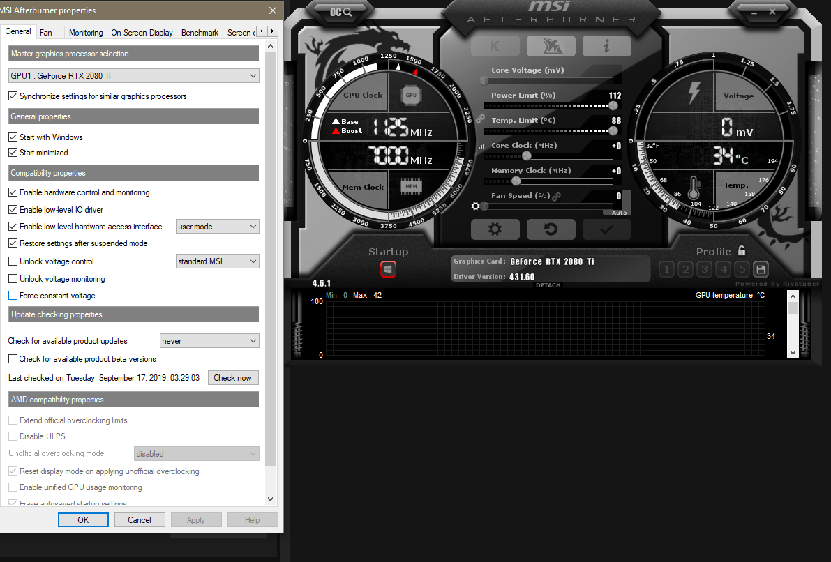

go Download MSI afterburner and use that to monitor your GPU and set a custom fan curve that runs at start up.

you cant close the software, need to minimize it to your system tray. If you close it out, it stops working. Also, make sure you hit the windows icon in the lower left corner to tell it to run at windows startup.

do you see the fighter jet in your system tray? If not, open the options of in Afterburner and and click the boxes to start up with windows.
Nono I did end up being able to use afterburner and it worked and I set it up so it would start (minimized) on boot. No issue there. Still just trying to figure out why the original solution (Radeon software) ended up failing.
