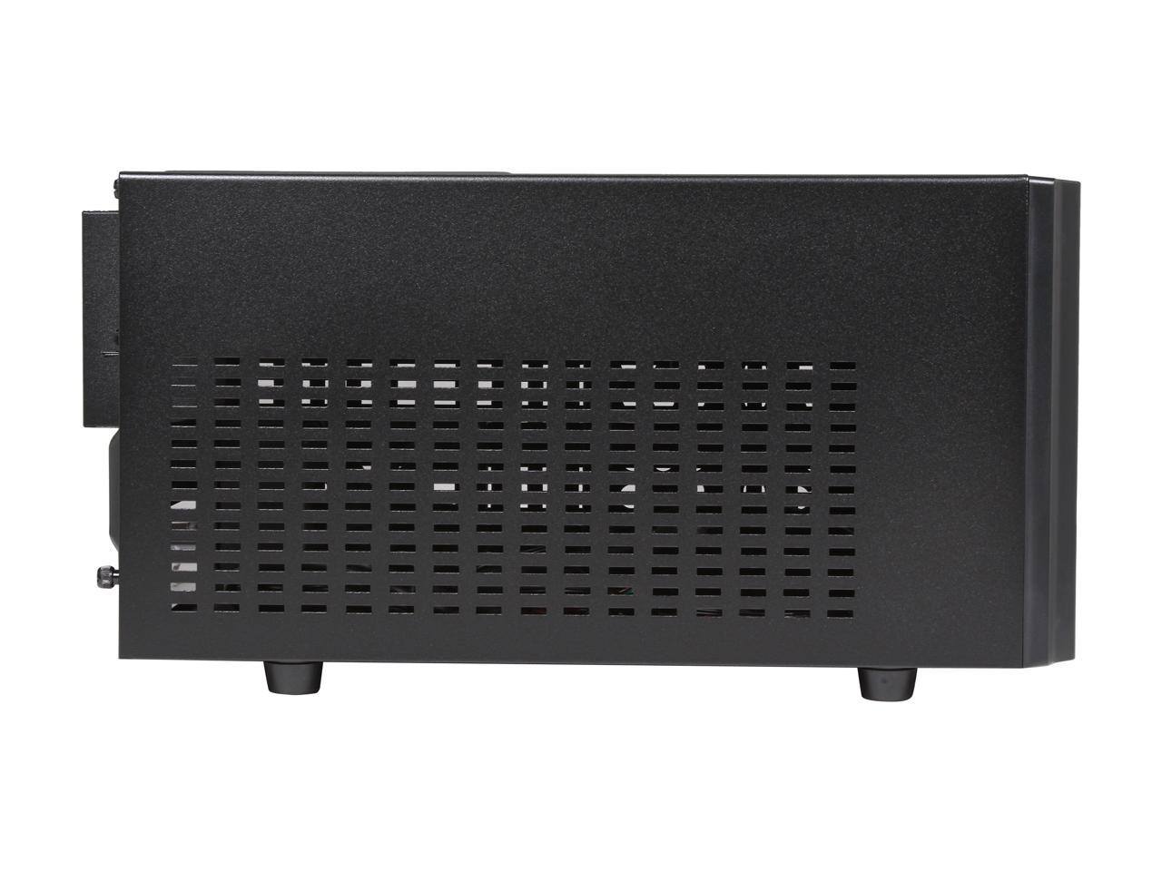

Barely any, the side it's next to does have vent holes in it though. If needed I'm prepared to modify it, hopefully not.
This is how it currently is and what I could do if necessary, with a bit of cutting and drilling
Ye those vent holes should be enough to get good air to your GPU.
Modding the side panel would definitely help since that's seems very restrictive.
1 hour ago, WoodenMarker said:
Unless there's some higher rpm version of the Ultra Sleek Vortex 12, it only has 1 more cfm and much less static pressure according to specs. Pretty sure it'll perform worse than the NF-A12x15. The main red flag is the low rpm.
Either an adapter or motherboard works. I prefer a gpu fan adapter with a splitter for two fans on the graphics card.
