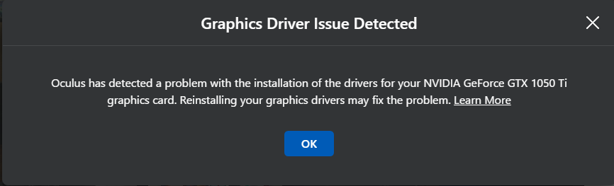

I got an Oculus Rift S and, while attempting to set it up it showed an error with graphics drivers. I tried using 3 different drivers (430.86, 436.48, and 417.71) and they all showed the same error. I've attached a screenshot of the error for detail's sake but it doesn't say much. All of the drivers were uninstalled using DDU in safe mode. If it makes a difference, the vega 8 graphics onboard do appear to have drivers (as in the amd drivers exist) but the gpu itself isn't in use. I started a support ticket with Oculus and they just redirected me to nvidia. There, they just sent me the latest drivers then told me my gpu was incompatible (which I can't see how, as it's listed as the minimum spec on the Rift S specs list).
SPECS
r3 2200g
MSI B350M Gaming Pro
EVGA 1050ti SC
8gb ddr4 2666mhz
Any help would be appreciated, thanks!
