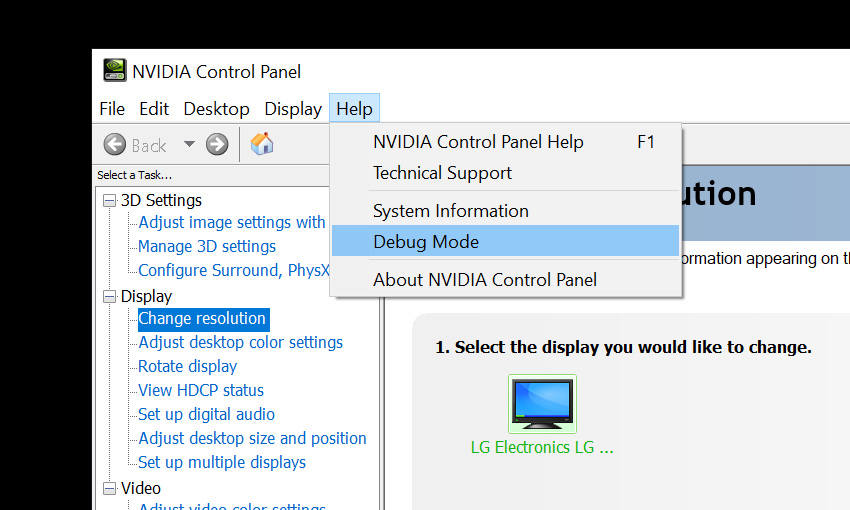

Instead of underclocking use debug mode. It takes off the factory overclock.
If the GPU still crashes RMA it and tell them about using debug mode.
Ok I will try this because I actually still had the issue when it was underlocked.
Will this permanently enable itself(will it still be enabled when I shutdown and turn on PC)? because I was able to play GTA for an hour with no issues.
Will this permanently enable itself(will it still be enabled when I shutdown and turn on PC)? This so far has fixed it for me.
If it fixed it RMA the card it is faulty.
I think it stays on. I only used it with a Gigabyte Extreme GTX 1080 for some games. Since 90% of the games worked with it i did not RMA the card.
