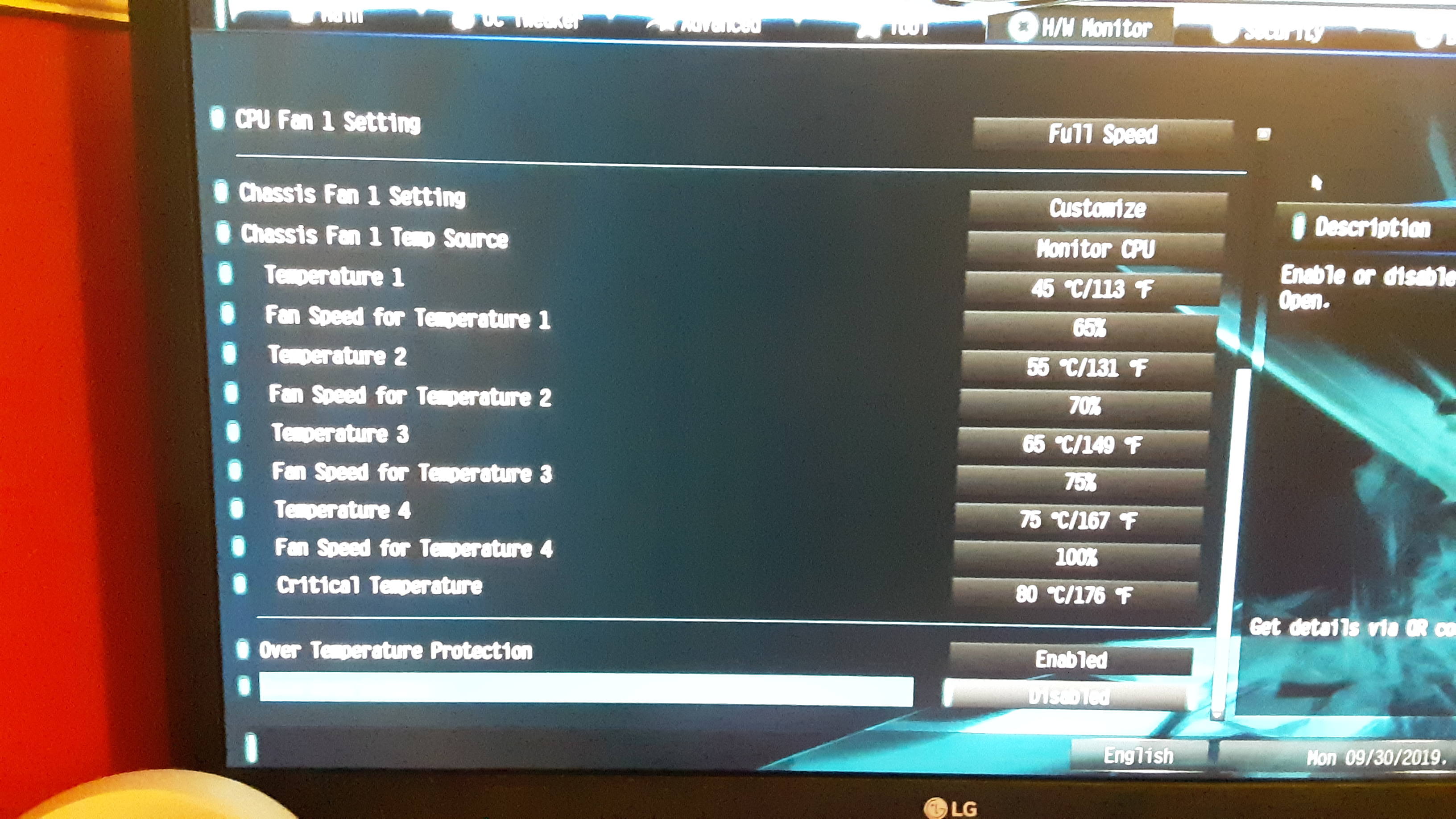

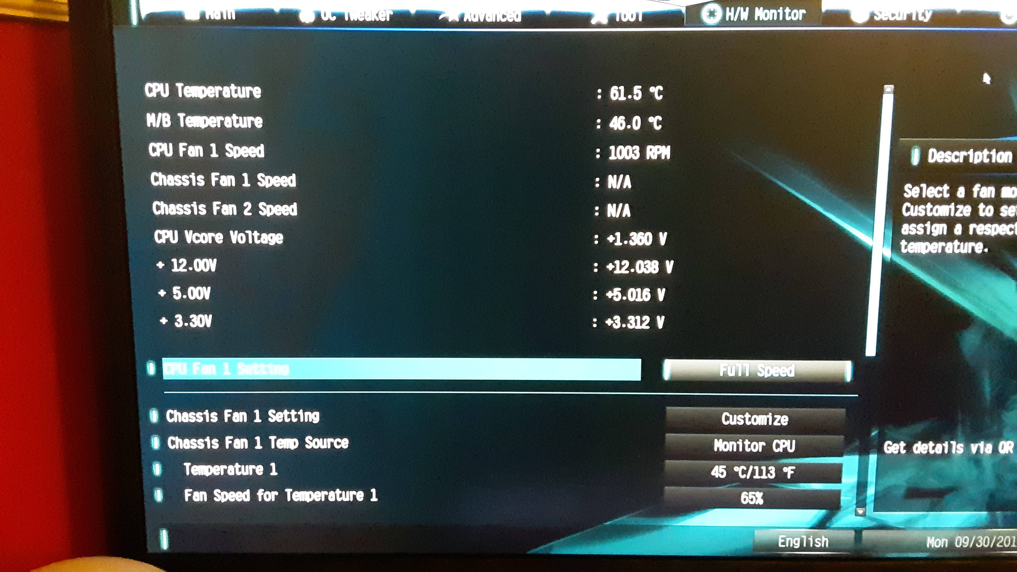

Yes, I tried that. I also changed the fan curve on both headers.
https://linustechtips.com/topic/1109480-fans-hate-my-fan-hub/#findComment-12931943
And they are also configured as PWM control? The fans should turn on at full speed if there is no rpm signal line made back to the motherboard.

I didn't find that control mode switch, but even if they aren't receiving rpm signal from the 4 pin, there is no spinning.
