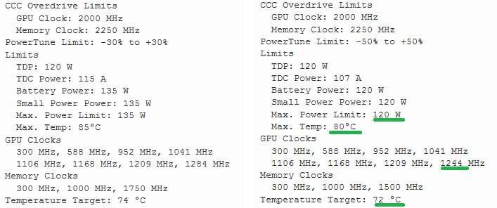

It probably has a lower maximum power budget in the bios and slightly lower gpu and memory frequencies by default.
Standard 2 fan version : https://www.techpowerup.com/vgabios/191558/sapphire-rx570-4096-170306
single fan version : https://www.techpowerup.com/vgabios/202527/sapphire-rx570-4096-180105
differences highlighted below
Basically the 2 fan version can go at higher temperature because the 2 fans push more air than single fan and they can react faster and cool card if the temperature goes above 85c faster. You get a big higher frequencies on gpu and memory - the memory you can probably safely overclock back to 1750 mhz (i don't think they use lower grade memory chips on the itx version) and the gpu frequency probably also can go regular but you'll get a slightly more noisy video card.
Also you see the 2 fan card has a 135w max budget vs 120w budget for the other, so less overclocking potential in theory.
So In theroy i am not getting a huge performance difference?right? It is basically same
