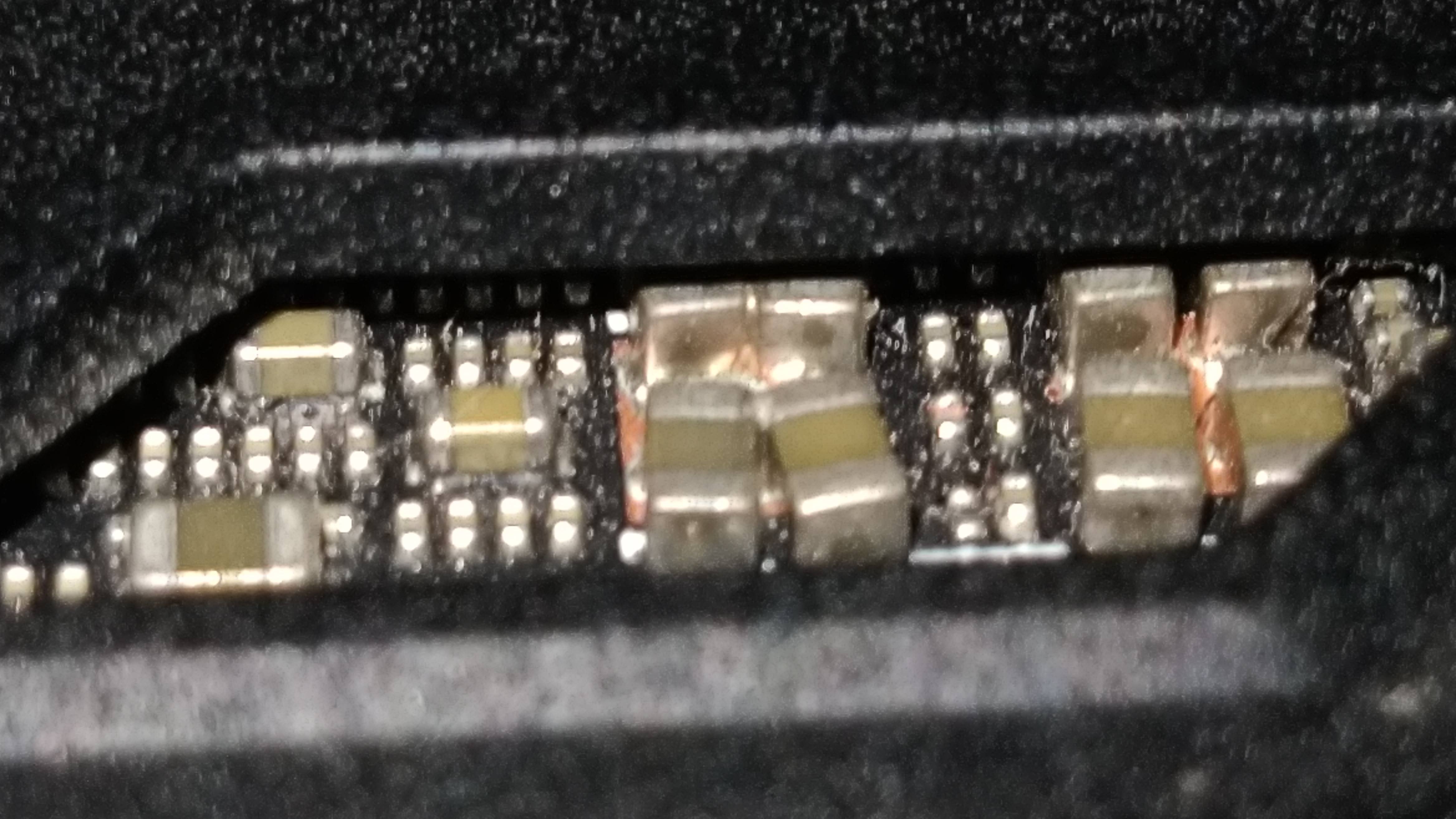

Touching caps on EVGA RTX 2070; ran for 4 months before dying!
This is mind fucking me.
That's the bottom of an EVGA RTX 2070 SC Ultra with the backplate still on.
How did this get past QC?
But more importantly how did it work for 4 months before it stopped powering up?! And 0 issues in those 4 months.
I can't imagine they migrated. Never saw temps past 65C. Maybe if there was a VRM under it that had a poorly place thermal pad and that was getting too hot? But that feels like a stretch. It's possible, but seems very very unlikely.
It does make me want to open it up and see what else might be going on. But I don't want to give them any excuses to void the warranty on me. Ironically I was going to redo the thermal paste this weekend. At least it died before I got to that I suppose?
I'm getting it RMA'd. But I'm a new streamer/YouTuber and it's shut me down. I don't have funds to get a new one and resell the RMA, or do their collateral RMA flange.
Mostly sharing because this seems very uncommon and wondering if anyone else has had touching capacitors on anything previously?

Those two caps seem to be in parallel anyways, so it doesn't matter if they're touching physically as well.

Nah something else's wrong. You can't short anything that are connected parallel in the first place.
Impossible. You can't melt solder even if the component blows up, the explosion doesnt last long enough.
"As in a series circuit, if a branch in a parallel circuit develops a short extremely high currents may flow through the short circuit. The voltage across all branches of a parallel circuit will be zero with a short circuit."
I'm not sure of you're correct. Electronics class was a long time ago, so I looked it up.
I was having a "USB overcurrent error" before the GPU died. Which would be congruent with a short circuit in parallel if those caps happen to have anything to with the USB-C port on the card.
My motherboard died before the GPU. Can't help but wonder how related they are.

What you quoted isn't relevant here, mate. If they are in parallel, the two caps are directly electrically connected anyways, so it just doesn't matter if there's a 1mm gap between them or a 0mm gap.
Yes, there could be an issue with those caps, but it certainly isn't because they're touching. The issue would exist anyways since, you know, they are in parallel.
It's pointless to go quoting random stuff on the Internet without understanding what you're quoting.
How do you know the ones touching are in parallel? It seems like an assumption more than a fact.
They're in a cluster of 4 over an orange colored square on the PCB. You can't see the traces on this side. They could be in parallel, but the other way, so the ones touching are not in parallel. Or they're in series. You can't tell just by looking at it.
If you have a circuit diagram of the card showing that piece please by all means post it.
And yes circuits in parallel can short. But it does depend on specifics and nuance. A general sweeping statement that "parallel circuit can not short" is incorrect.
Of course it is an assumption, like I literally said in my first comment. I very fucking literally said that they seem to be in parallel.
Not once did I say that parallel circuits can't short. Again, I said that if those two caps are in parallel, it doesn't fucking matter if they're physically touching or not, because they are shorted together anyways! They'd already be directly electrically connected!
Here, a picture to demonstate it:
Above, there's a gap between the two caps in parallel and below there isn't a gap and, lo-and-behold, it DIDN'T CHANGE ANYTHING WHETHER THE CAPS WERE TOUCHING OR NOT.
Now that I have gone and even given a picture for you to look at, I'm leaving this thread and you can fuck off with trying to put words in my mouth that I didn't say.

Anyway it's been sent in for RMA. The EVGA Support people I talked to agree it shouldn't have been working in the first place.
I asked for follow up with technical details when they RMA. Maybe we'll get to learn more from the source?
And you're still making assumptions. The could be connected so that the vertical ends are the parallel circuit.
You're assuming their orientation and how the circuit is connected without data or proof.
Just because they're beside each other doesn't mean they're in parallel.
They could be. But they could also be in series. Or a parallel circuit connected at their vertical ends.
