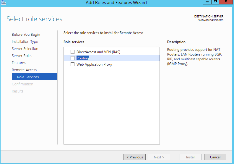

Do you use Windows server? Then installing the router role on your server might be part of the solution. See picture in spoiler bar.
