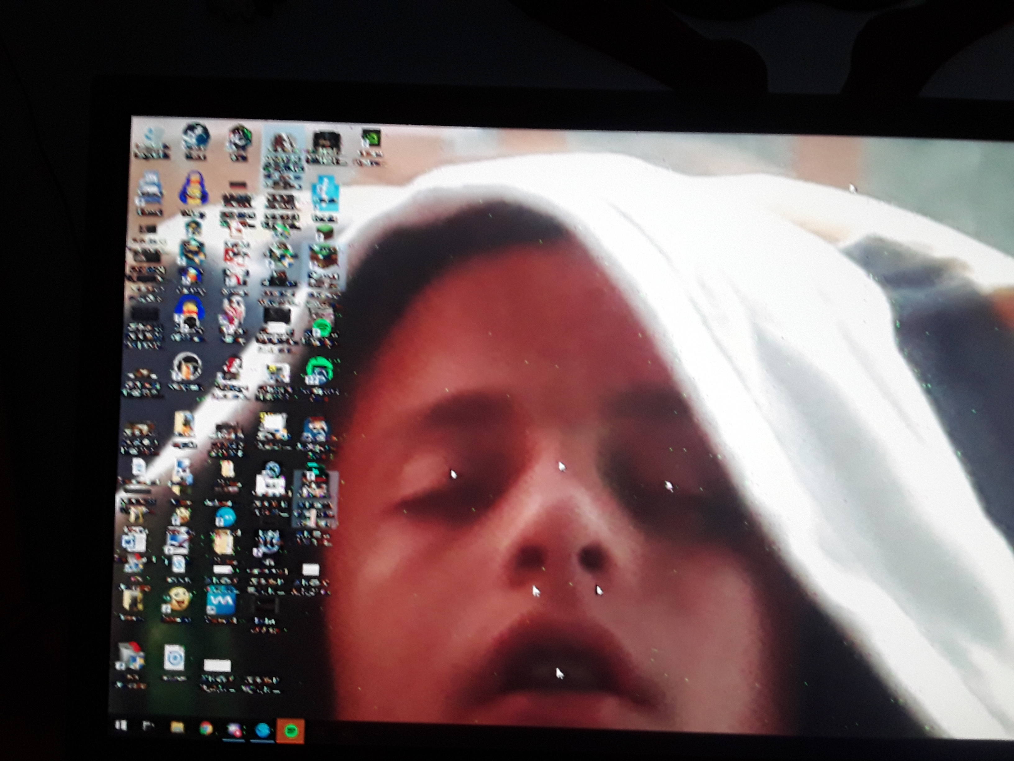

The 670 is my friends. I managee to boot now but the screen is full of artifacts and bad resolution. I installed drivers but i dont see nvidia control panel with right click so im reinstalling now.

It was ok with out drivers but in the middle of instalation the fans ramped up and thennthe artifacts started again.
