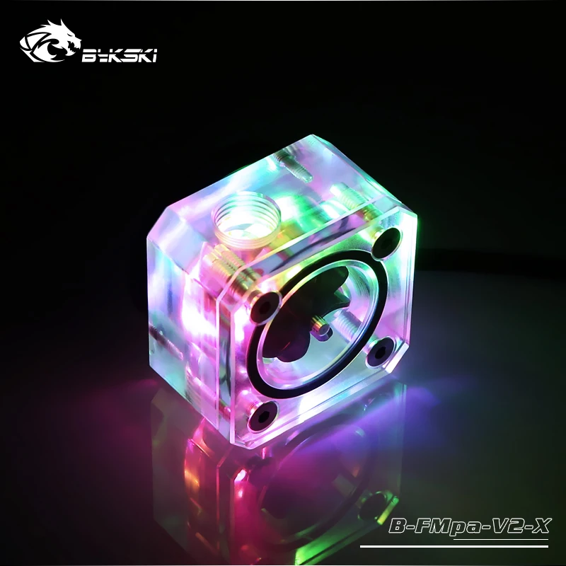

Byksk:Jst 2.0 PH 4pin to 2+1 3pin argb connector ( some of there stuff come with an adapter to go from byksk to 3pin argb connector. you can also buy the adapter cable by it self. also there a big and small hub)
