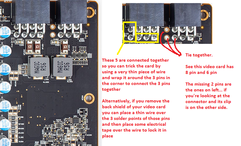

Try powering the video card with the 6+2 and 6 and see if it starts.
The extra 2 pins on a 6+2 connect are ground wires, which just tell the video card "this connector is strong enough to give 150w instead of the regular 75w.
The video card may accept and start with just one 6+2 connector.
You can get a pci-e 6pin to 6+2 / 8 adapter cable, here's an example: https://www.amazon.com/Cable-Matters-2-Pack-6-Pin-Adapter/dp/B01DV1Z32Y/
If the video card won't start with only 6 pin and if you're feeling adventurous you could trick the video card into thinking you inserted an 8 pin connector.
You just need to fake you inserted those 2 wires:
I have one of these adapters that turns 6 into 8, although one of them is a blank.
I was kinda hoping someone would say this is fine and it won't kill my gpu, cause I'm not feeling that adventurous, specially after spending some money on components already, but if it's not safe then I guess I'll just wait until I can get a cable
