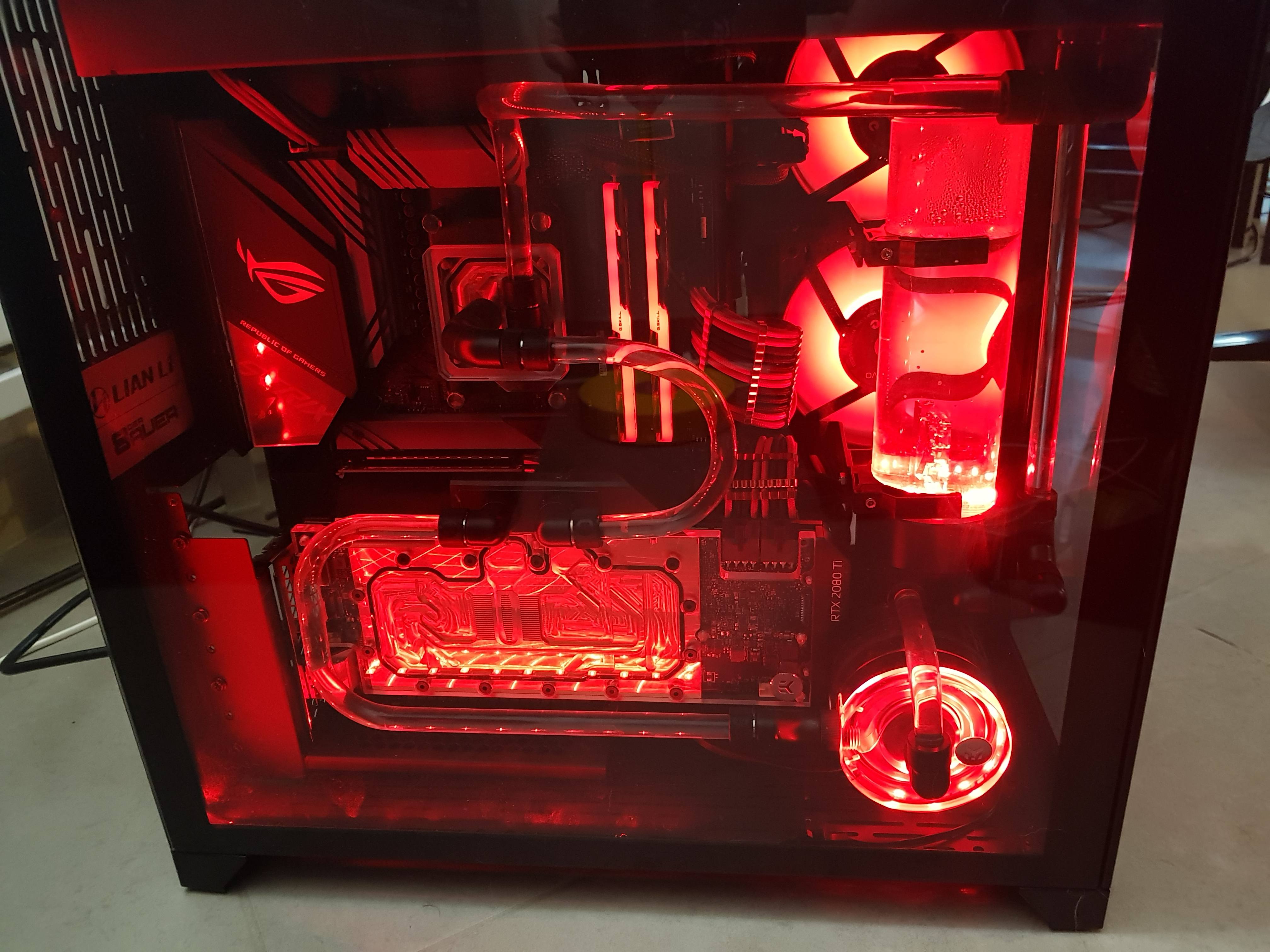

My brother rencently bought some parts to make a brand new machine (we decided to go full custom watercooling this time)
here are the specs:

We are watercooling the CPU + GPU in a single loop with a 360 radiator, all the parts are from EKWB (i'll try to add some photos)
  We first received all the parts like mid july, and we first ran the system in only air-cooling to see if all the components were fully fonctionnal and stables (it ran like that for about a week without any problem whatsoever) and then we decided to start building the watercooling system.
Once the loop was completed we turned on only the waterpump (standalone D5) for 24h to make sure there were no leaks and then turned the entire system back on
