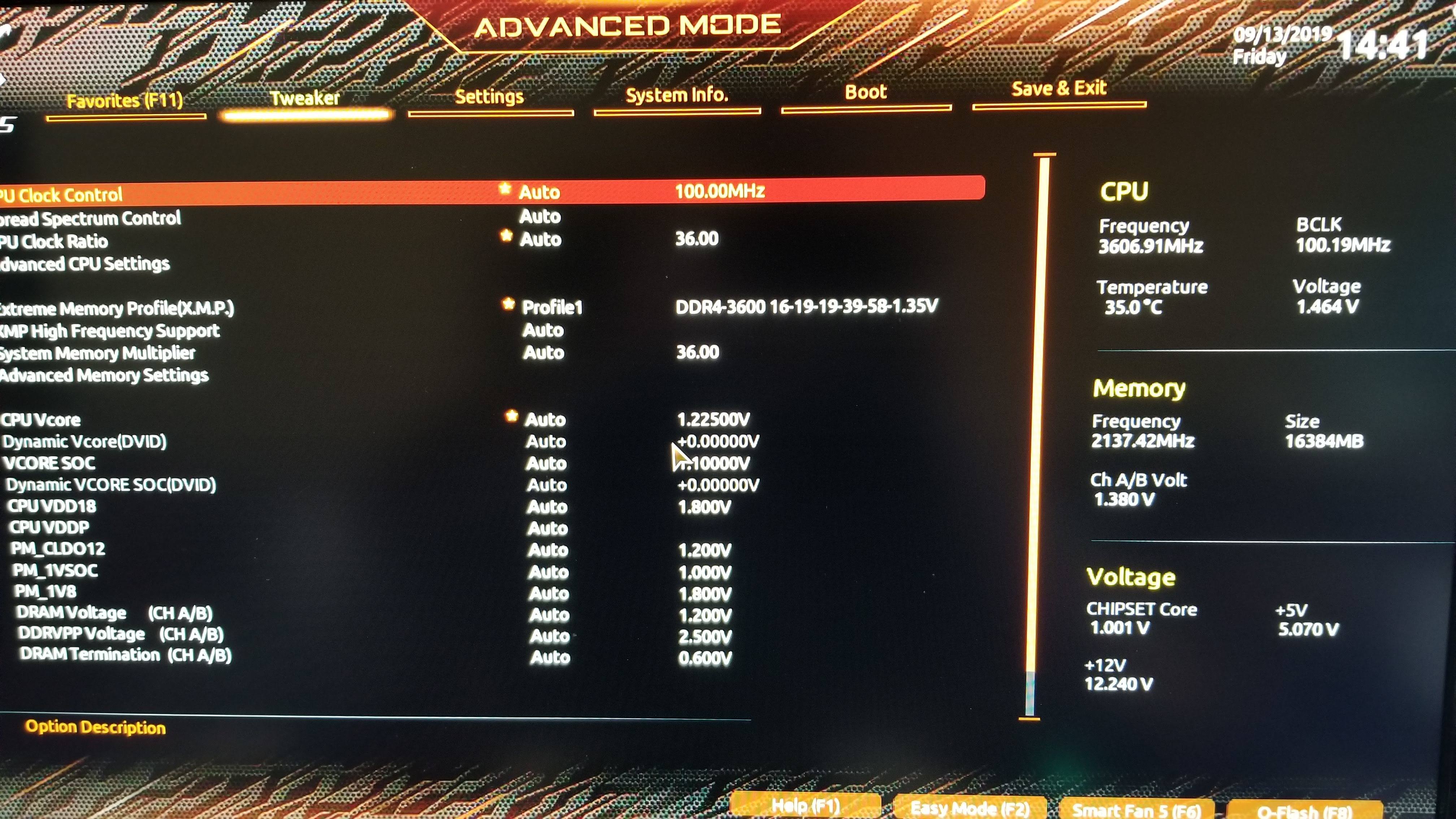

I am running an 3700x on Gigabyte X570 Aorus Ultra (F5 bios).   I purchased the GSKILL TridentZ Neo 16-19-19-39 2x8GB kit (F4-3600C16D-16GTZNC) for RAM and installed in A2\B2 slots as the manual recommends.  If i go into the bios and enable XMP and reboot, the system runs as expected,  Memory and Fabric clock at 1800, memory timings show as expected and the system performs well.  I have run games, benchmarks etc without issue or crashing.  Using the provided cooler the CPU temps are in the high 60's under heavy load (ex Cinebench R20).
My issue is whenever I power on the computer memory defaults to running at 2133 (or 1066MHz).  If i go into the bios again it still shows XMP enabled but the Memory frequency is  2133 (see screenshot)..  All I have to do to get it to go back up to 1800 is click "save and exit" in the bios.    That seems to trigger it to go back up to the correct speed.
Before you say QVL, I have checked and that specific RAM is not listed on the gigabyte QVL list from their website but G Skill site claims this memory is made for the X570 and is certified for this MB here https://www.gskill.com/qvl/165/326/1562840073/F4-3600C16D-16GTZNC-Qvl.
I have also tested turning PBO on and found a good performance boost with it.  I am not sure if it is related but i also figured out that if turn PBO on in Ryzen Master it gets turn off after every power off as well.    Is that normal behavior?    I am not sure what settings are suppose to survive reboots, but i am fairly sure the memory should remain at 1800mhz....
Any suggestions or thoughts on next steps?  Should i contact G Skill support?

CPU-Z matched what my screenshot shows frequency at 1066mhz.  Also running benchmarks showed a signification reduction in performance so i assume they are both correct and it is ignoring XMP on power on.   (Bios issue)
Interestingly enough, the next day after this post the system would not turn on.  The power button causes CPU LED on MB to blink twice.   No fans try to spin, nothing.  I tried another PSU, removed the cmos battery (and power).  So at this point i am going to return the board and see what happens with the next one.
