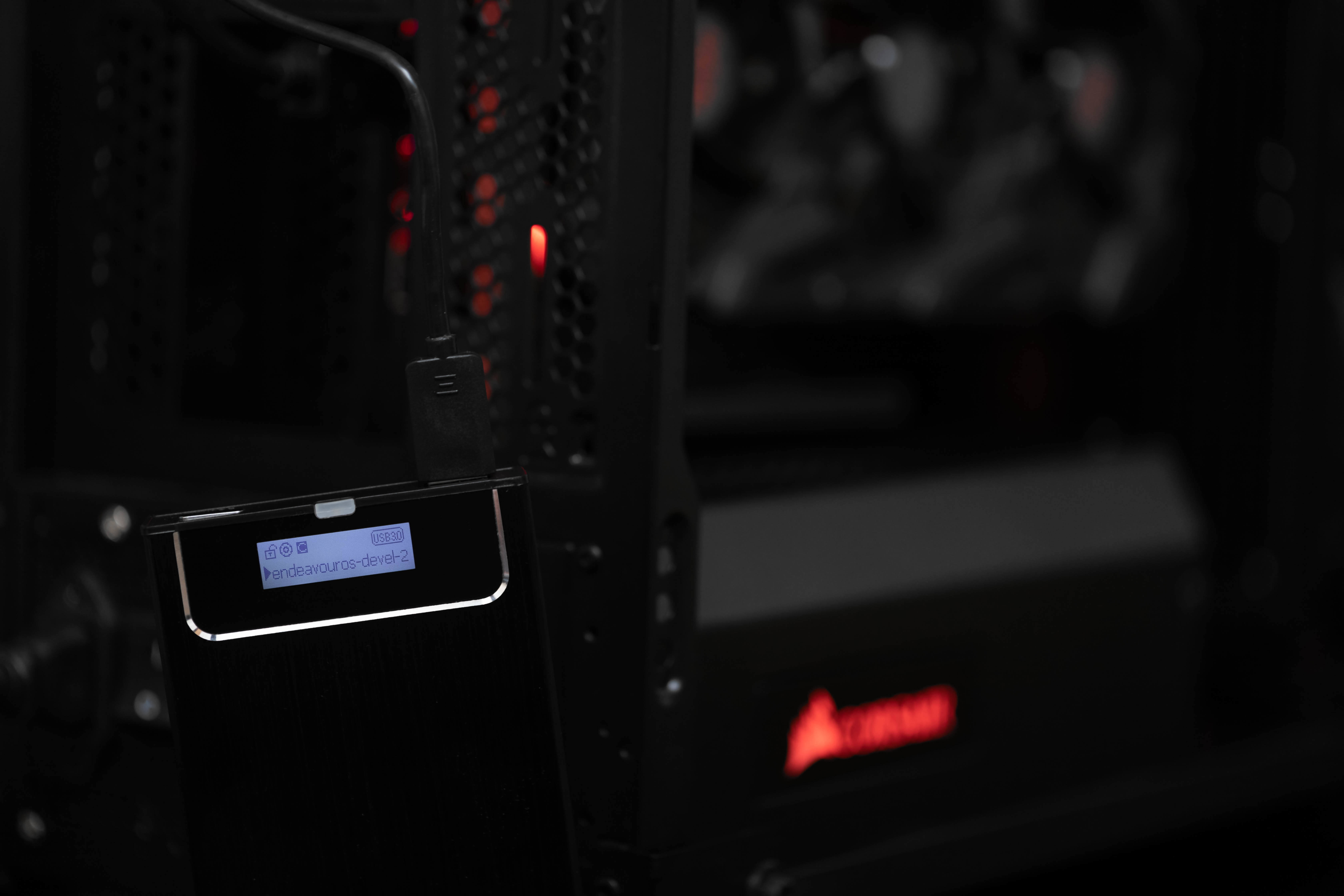

I have one of these (Iodd2531), so my Rufus days are over.
Just drop the ISO into the ISO folder and pick it from the boot menu.
It can even boot VHDs.

Neat bit of kit. I just plan on buying a pile of cheap 8GB thumb drives and labeling them all with OS installers made from dd or Rufus.
