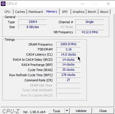

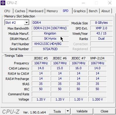

Kind of a noob here, the spec sheet says they both are 14-14-14 at 1.2V but how do i adjust them? and how do i change the speed as well?
I've attached two photos for reference below of CPUZ memory and SPD tab
The only thing I worry about is getting into compatibility issues and killing one of the ram as i've done it some years ago on an older system.
