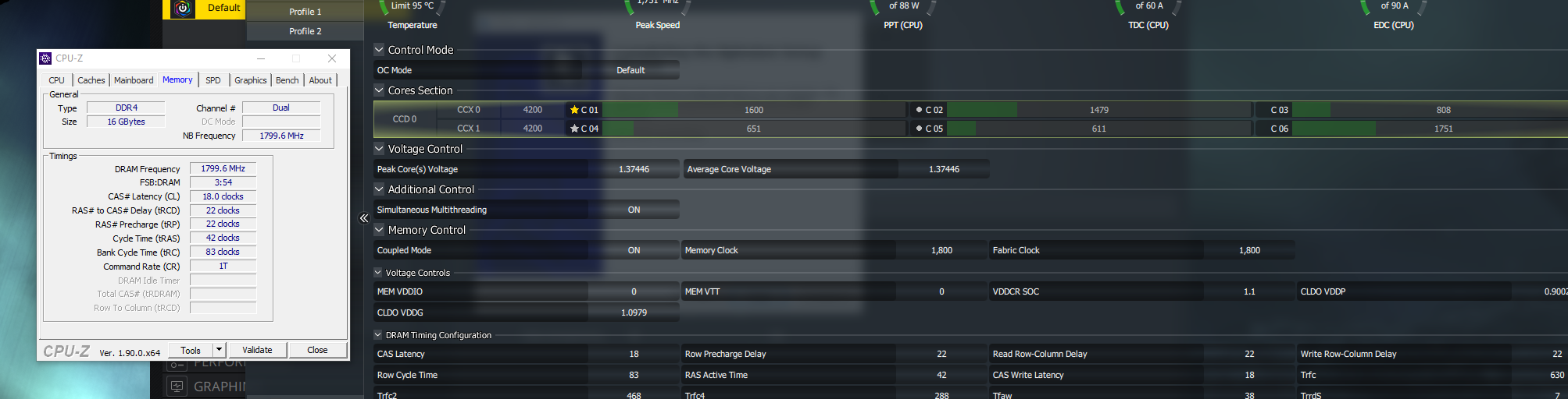

so does it all look good on that photo??
what about that nb frequency?

i turned the thing on in the bios and now in ryzen master its ays 'memory clodk 1800' but my ram is 3600. is there some ration i neeed to set???
It runs at 2 x 1799.5 = 3,599 Mhz , with 18-22-22-22  timings.  Click on the SPD tab and check the profiles... see if there's some better timings for your 3600 Mhz configuration (doubt it)
It shows there that it runs in coupled mode, meaning the memory controller runs at 1800 Mhz, same as the memory sticks, which is perfect. It's slightly better performance (lower latency) if the frequencies are the same in both controller and memory sticks.

so on other computers, the nb frequency seems to be double the memory frequency, but mines not. why??

but what about the nb frequency? on all my other computers its like double what it is here its between 3k - 4k and here its same as ram. is something broken there??
There's no northbridge chip anymore. Traditionally, the northbridge contained the pci-e controller, the memory controller and optional integrated video card and made the connection to the southbridge which contains the peripherals (sata controller, usb controller, extra pci-e slots, pci, bios, ps2 keyboard and mouse, other things).
Nowadays the pci-e controller and the memory controller is inside the CPU and the memory controller works at the same speed as the memory, which is 1800 Mhz.
The latest Ryzen 3xxx series can actually "decouple" from the memory frequency, for example you could have the memory controller at 1800 Mhz and the memory at 1500 Mhz (for 3000 Mhz memory sticks) so you get better performance compared to staying coupled at 1500 Mhz. Previous Ryzen generations had to stay in sync with the memory stick frequency and that's why Ryzen processors worked faster with higher frequency memory.
Now, the effect of slower memory is less pronounced with Ryzen 3xxx processors. You still have a benefit, just not as pronounced.

sorry i dont understand.
so that frequency means nothing?
i read online that the nb is how fast cpu reads ram and its double ram speed because its dual channel - so thats rubbish??
my alienware 17 has it double its a 8th gen intel cpu.
NB is short for northbridge.
In the past there used to be two big chips on the motherboard: northbridge and southbridge.
Over time, to improve performance of processors, the functionality of the northbridge chip has moved inside the processors, so there's no longer a northbridge chip.
Ryzen processors have a thing called Infinity Fabric ... think of it as a super highway to which everything is connected : the cpu cores, the pci-e controller, the memory controller, the southbridge (chipset)
The higher the frequency of this Infinity Fabric, the faster the data will be moved to processor cores and other things on the highway.
For this reason, it's ideal that the memory controller frequency is the same as the Infinity Fabric because if the numbers are mismatched, from time to time it could happen that the Infinity Fabric is ready to receive data and move it along where it needs to go, but the memory controller isn't yet ready to give the data (data didn't arrive yet from memory sticks)... so the infinity fabric wastes a tick or several ticks (those Hz) waiting for data to be ready.
In previous generations, the Infinity Fabric frequency was locked to the memory controller frequency, so for example if the memory controller ran at 1200 Mhz (for 2400 Mhz sticks) so did the Infinity Fabric frequency, which resulted in lower performance.
In the last generation of Ryzen processors, they implemented a decoupler, making it easier to run the Infinity fabric at a frequency different than the memory controller frequency.
Dual Channel doesn't increase the performance the way you think it does.
Think of it like this: You have two trucks full of information but you have two warehouses: the first warehouse has one unloading bay, the other warehouse has two unloading bays.
If you use the first warehouse, the two trucks arrive one after the other, and if each truck unloads in one hour, you need two hours to unload both trucks.
With dual channel, it still takes the same amount of time for the trucks to arrive to your warehouse, but both trucks unload at the same time, so it takes only one hour to unload both trucks.
So with dual channel mode, the frequency is the same (the speed of the trucks and the distance to your warehouse is frequency in this analogy), but because data is read or written to two memory sticks at the same time (loading or unloading two trucks at the same time), it takes half the time to obtain the data.
When dealing with memory, the memory controller needs a few nanoseconds to send the command to memory sticks and the memory sticks need some time to prepare the data, and then the data arrives to the memory controller in a burst of time.
With dual channel, that burst takes half as long time, because each stick only transfers half the information.
