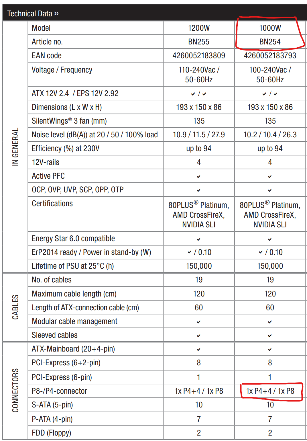

That PSU has an 8 PIN and a 4+4 pin (one 8 pin can be divided into two 4 pins, the other is just an 8 pin all the time):
does it have a dual 8 pin pci-express connectors
You don’t need two 8 pin eps. One is sufficient. Unless you are looking into LN2/ extreme over clocking
It has 8 6+2 pin (sometimes called 8 pin) PCIE connectors for videocards.
