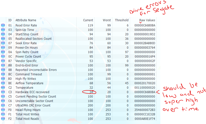

From CrystalDiskInfo
https://imgur.com/a/GdB5xdg
It might seem that your drive is failing. The Read Error Rate value is really low, since you don't want it close to normalize which is 67 for yours, and from the screenshot it is at 74. The other clue is that the Hardware ECC Recovered value is really high. I would recommend to check all your connections to the drive first, it could be a loose sata cable or power cable, then try another sata sable to see if that one is faulty.
Are you sure about it? What about this? https://imgur.com/a/t9vFjSK (It's the old one and i think it has worse Read Error Rate than new one.)
That is a healthy drive with the Error Rate, from what I've read the first 16-bit in the raw value tells you the drive errors for Seagate. If it is all zeros, you are fine. But your 2TB drive has a high Hardware ECC Recovered which is more concerning.

This only happened when I moved files to the HDD; anyways it was toast. The cache is for the storage of files that needs to be accessed by the CPU later on but not really needed stuff, so that doesn't matter. So what you are saying is it that it's fine, when you transfer files from the new 2TB HDD to the old 1TB. But it's when you are moving files from the old to new it's dropping down but not all the way to 0 MB/s? Pop open Crystal Disk Info again and check Hardware ECC Recovered on the 2TB, if it has changed a significant amount, then something is wrong with that drive.
It's not dropping too much when i transfer to another HDD, it was stable with 100-120mb/s then it dropped to 70mb/s for 3 sec so i don't have any issue when i transfer files from new to old/old to new. It's now 84/67/0/00000E144E09 (While i'm playing the game)
Alright, I will recommend you to install SeaTools for Windows and see if your drive is having any issues: https://www.seagate.com/ca/en/support/downloads/seatools/#downloads. Seagate says their program is more accurate for their products so if it doesn't detect anything wrong, I guess it is safe to say your HDD is fine.
