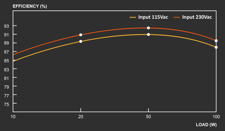

Efficiency:
A PSU takes power from the wall (115v/230v) and converts that to power your PC components use (12v and some 5v). With any transfer of energy, there is bound to be some current lost. PSU's have a certain efficiency in this process, at a certain % used. With these PSU's, the most efficient point is at 50%:
(With this graph, higher = better)
So what that comes down to, is that this series of PSU is most efficient at 50% load. Not that this should impact your power bill much at all between the 550W and 650W versions.. But it's a difference to mention.
The higher wattage PSU's likely use better components that create less heat, thus they have less need to turn the fan on at all times. Looks like this is all automatic though.

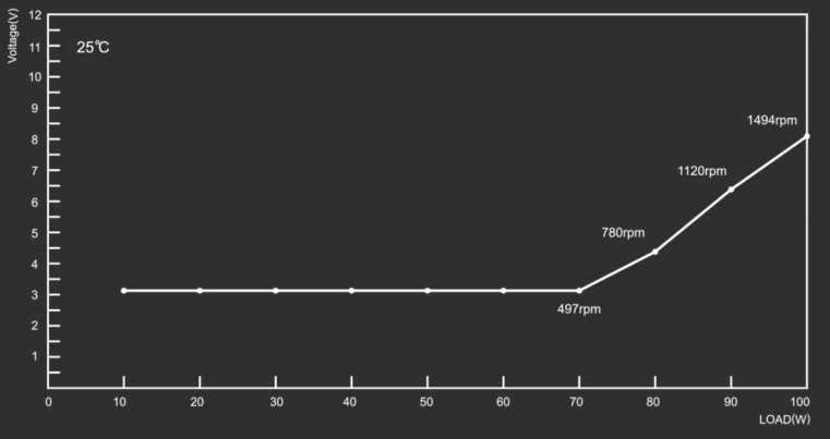

Im just dropping one of these here for you to look at.
This is a Bitfenix whisper m model.
If it works out ideally you want your idle power to be above 20% load and you max power lower than 75% to give you a little headroom and also on most units the fans start to ramp up real hard the closer you get to 100% load
Fan curve for this model:

Oh, it's this again...
Those are two of the most useless graphs I have ever seen.
The first one has a completely useless axis (10, 20, 50, 100).
The second shows you the voltage of your fan. Who cares about the voltage of their fan!?! ?‍♂️ It also shows the graph is a scale of "Load (W)" but it only goes up to 100. So at 100W that PSU's fan is drawing 9V running at 1494RPM? I'd hate to have dinner with the person who finds that interesting.

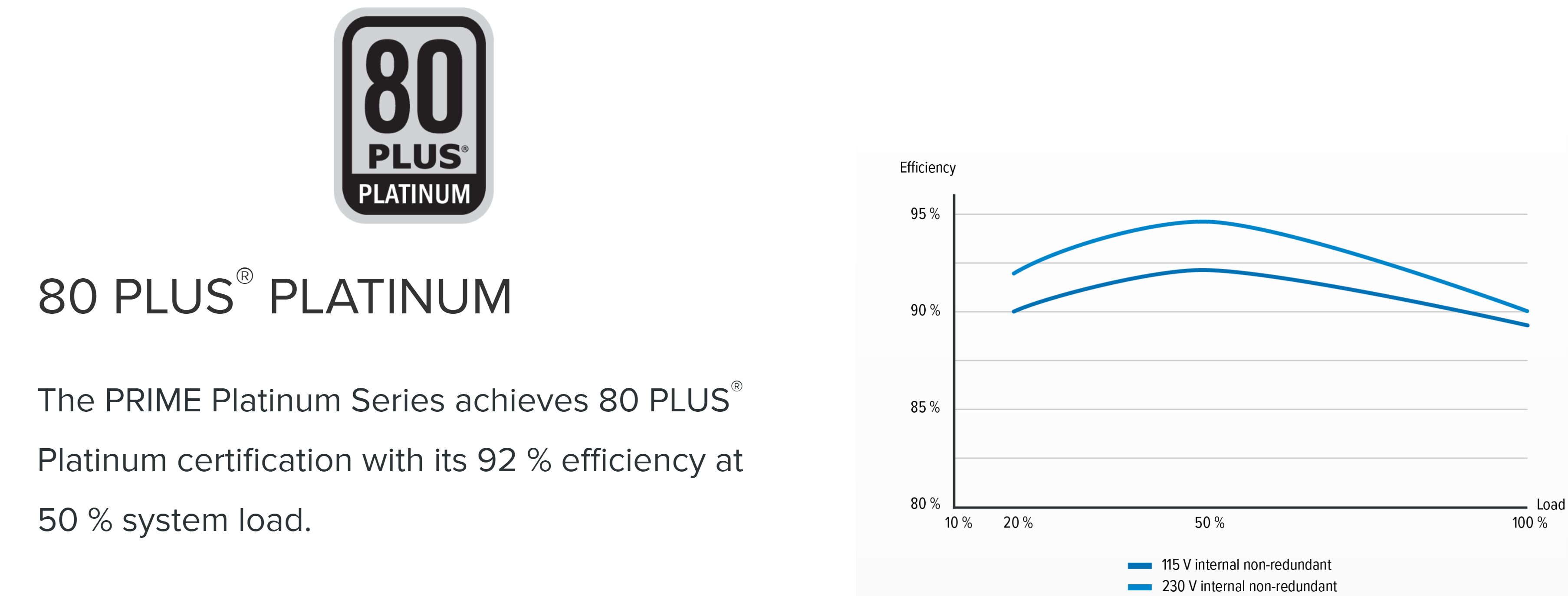

55 minutes ago, Minibois said:
The highest effeciency point seems to be at around 50%, meaning around 275W vs. 325W is the highest effeciency points on the 550W and 650W units respectively.
Can't find the efficiency curves for the new Prime Ultra Platinums, but as an example here's the efficiency graph of the old Prime Platinums from the people who do the 80+ certifications
Basically it doesn't matter. If you care about that extra 1% efficiency then buy the Prime Ultra Titanium instead of buying a higher wattage PSU to try and get in the "peak efficiency range".
How so?
Load(W) should be Load(%) ill give you that (and wtf Bitfenix, thats a really stupid mistake)
