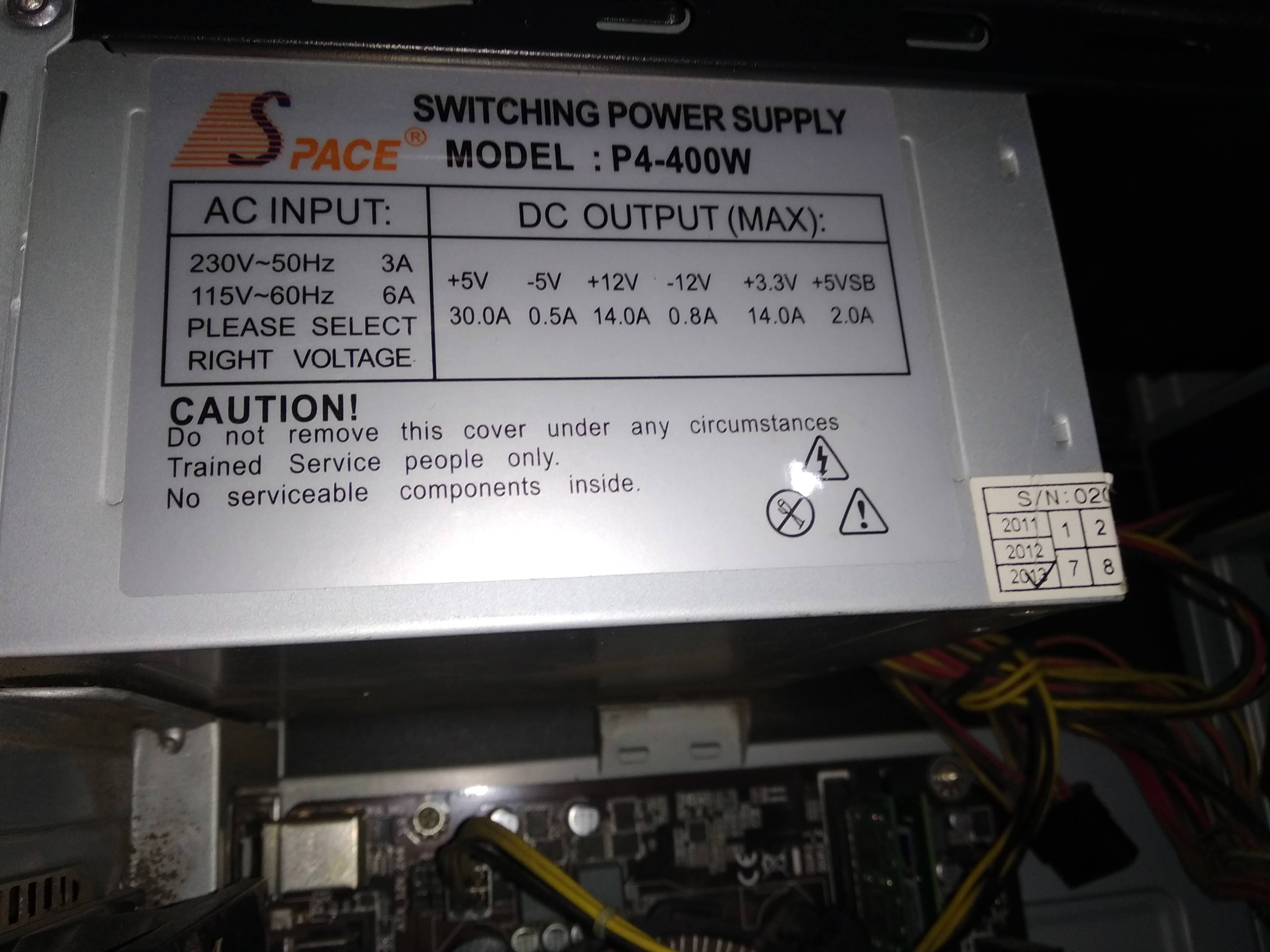

My budget for my gpu is not that much. 110$ is my budget for gpu. I have kinda no options for a new PC at this moment. My power supply is of 400W. The photo is given below. Sorry for the late reply. I had my exams. I've now tried playing pubg on my current build. I can already run pubg at low settings.

Get a new CX550 (2017) for 50$.
And then hunt down a R9 290x or 290 for 80$ afterwards. Or get yourself an HD 7970 for 60$ or R9 280x/280 for 60$.
Its a wonder you still have a PC...
You absolutely NEED a good quality PSU, if you don't want to kill your PC.
Yes, its that bad of a thing. you'd be better of getting a DELL or something like that next time. At least the PSU would have been OK...

Ok, first things first, change the power supply. As others have stated, that thing is a fire hazard.
If your budget is capped at $115 get this psu. It's not the best, but it's a hell of a lot better than what you have and it's $26 after rebate and shipping
Power supply
Then get a rx 470 from Ebay. Like this one:
Rx 470
Offer the guy $65
