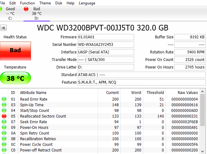

My response time is around 200-3000 ms. It goes to 0, jumps up, goes back down and repeats.
7 hours ago, Wolly9102 said:
What disk do you have?
asmedia ASMT1053 SCSI Disk Device, that's what it says on task manager.
Also, I've never had this problem before (as far as I know). I had to reinstall windows for another issue and noticed that it was at 100%.
Is the only solution to get something else?
This is a problem of it's own. It's supposed to show the disk name. Not the controller. Can you download crystaldiskinfo and check what drive it is

41 minutes ago, dontknowwhattoputhere said:
That's your problem right there.(why it's so slow) That drive is dying. I suggest you get your data off as soon as possible

On 3/29/2019 at 8:38 AM, dontknowwhattoputhere said:
Ah, ok. I'll need to buy something else then.
Thanks!
