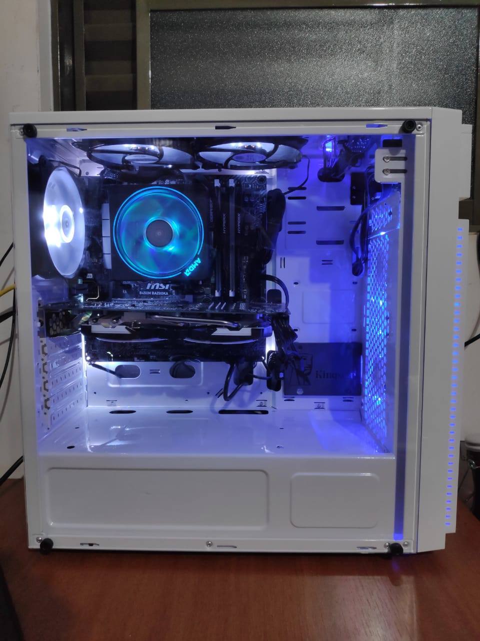

Hello,
I would like to ask some help about how to configure the fans of the case I bought in a proper way.
The case I bought is this one: (Bluecase BG-015 white)
Resultado de imagem para bg-015
Now, the front fans have clearly low space for the 2x120mm fans to intake a good amount of air in order to have a positive or even neutral airflow.
So, my thoughts, even knowing the hot air tends to rise up, but, I thought about putting the 2 top fans as intake along with the 2 front fans,
and for exaustion I would use the rear fan and put a small one below the GPU, maybe a 80mm will fit.
I thought about that because I have an air conditioner on the top of my wall, so a lot of cold air is being thrown downwards, which then would reach the top intake fans.
What do you guys think?
Ah, and of course, I will think about a way of filtering the dust of the front intake fans.
the top fans already comes with a nice magnetic filter.
Thank you in advance.

My other 3 fans arrived along with the fan controller.
Before, I was running just two 120mm fan, 1 top for exaustion and the rear fan as intake... (pretty bad scheme tbh)
The temperature playing Dauntless on maxed graphics was reaching 85~90c... so I was worried.
Now, I installed with the scheme I mentioned, 2 top fans as intake, 2 front as intake, and rear fan as exaust...
The temperature now is between 65c~80c... Pretty nice tbh, I will stay like this.
I understand that the top fans should be exaust, since the warm air tends to go up, but,
Why this cheap case creators placed a dust filter on the top fans then? hahaha
Thank you all.

A top filter can be used to reduce the amount of dust settling into the case and allows for the option to use the top as intake without letting in unfiltered air.

Indeed, when it's off, dust can fall there... Now I am looking for some kinda of mesh, to make a custom dust filter for the front intakes...
Worst case scenario, I will just cut my woman's pantyhose...
Hahaha
In a computer case with fans moving/forcing the air, there are really none thermal rising of hot air as it is pushed out with the airflow front to back. And top fans didn't became mainstream before AIO:s and watercooling became mainstream. If you don't have a top mounted radiator the point of having top mounted fans is gone. It cause more turbulence and disturb the desired path of airflow from front/bottom to back. Plus that the perforated top makes it harder to have a controlled pathway as the law of nature (and mankind) is to take the shortest path possible so the back fan sucks air in from the top and out the back instead of pulling air from the inside of the case, likewise for the CPU-cooler. So without a dust-filter you suck more unfiltered air in though the top instead of the filtered inlets in the front and bottom of the case.
There is a reason server-chassis  don't have mesh as the key to cooling is to control the airflow from front to back.
