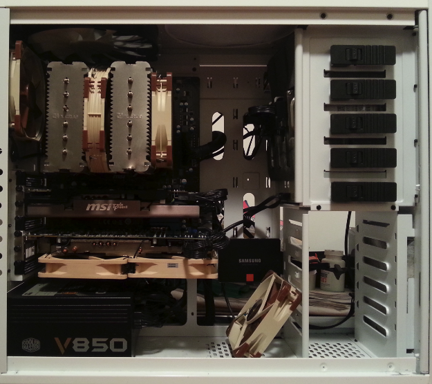

#13 DavidL.Roth
DavidL.Roth
    Member
  • Member
  • 32 posts
Posted 31 March 2014 - 01:57 AM
Ok this thread is starting to become kind of a monologue where I speak to myself.
I removed my GTX 770 from the motherboard and took a look into it.
Seems like the Windforce cooler is connected with only 4 screws to the cooler block.
Two of these screws can be accessed directly from the side of the card, but for the two others it'll be difficult.
I could bend small screwdriver to 90 degrees angle and try to use it...
Screw places shown here (under the top plastic).
When the fans (test ones) are layed over the existing cooler, they are just slightly larger than the Windforce plastic shroud.
I believe this wont be so ghetto looking when it's done (if I do it).
#14 DavidL.Roth
DavidL.Roth
    Member
  • Member
  • 32 posts
Posted 03 April 2014 - 02:28 AM
Okay, I tried it after getting confirmation of safety from Scythe and (second confirmation) from Gigabyte.
Mixed feelings.
All the stuff needed:
Assembled:
I got lucky with this screw since I could fit this small screwdriver through that small opening:
For the last screw I had to sacrifice this screwdriver and bend it with pliers:
Success:
Scythes sure look cool:
I used steelwire to bend the clips holding the fans in place. It's called piano wire in my country, don't know about USA and other places, it's extremely hard to bend and cut, and is kind of "springy" (not ordinary steelwire):
Looks good enough to me, not ghetto:
Done. I just need to cut those cables short and do some soldering (or zip tie them neatly):
Now for the noise and temperatures.
Idle noise is same as with the stock fans, although there is small clicking sound with the Scythe fans running at low speed.
But it is almost absent and I think I could get rid of it by putting something dampening material between the fans and the radiator.
Note that my PC is quieter than the Logitech subwoofers (sitting next to it) electric buzz when it's on (god damn silent), so the clicking is not loud at all.
I played DayZ Standalone 1080p everything maxed out about 20 minutes.
Temperature maxed out to 64 degrees celsius.
Hell of a lot better than with the stock fans.
Sadly the noise level was not that silent (primary reason of the mod). Maybe it could be because the GPU controls these fans the same way they control the stock fans (not knowing they are 120mm)?
Also there is bulk of air pressure lost to the side of the GPU where the fans overhang it.
But the noise was low hum instead of that whiny noise what stock fans make. But it was not quiet.
Also played Red Orchestra 2: Heroes of Stalingrad for about 15 minutes.
This is not nearly as demanding game for PC as DayZ SA.
Max temperature was 55 degrees celsius, everything maxed out 1080p.
With stock fans the temperature rises fast to 71 degrees celsius, this was huge improvement.
I have to say that with this game the fan noise was quieter than with the stock fans.
I will be considering buying that Prolimatech MK-26 Black, it might help with reducing fan RPMs.
Also, I'll try to test MSI Afterburner for controlling the fan speed.
So what do you guys think?

#15 DavidL.Roth
DavidL.Roth
    Member
  • Member
  • 32 posts
Posted 03 April 2014 - 06:15 AM
Second test gave a bit better results.
I detached the fans and put dampening material between the fans and the radiator.
Also put dampening material between the two fans. Then I zip tied the loose cables to give it more tidy look.
On top of that I moved my Fractal Design Define Mini front fan (Scythe Gentle Typhoon) from to upper position to the bottom position, now it gives more cool air to the GPU instead of CPU.
Results after playing 12 minutes of DayZ Standalone:
Max was temperature 65 degrees celsius (case closed and case fans at minimum speed).
With the case side open or the case fans running faster it will stay cooler than that.
But the most important thing was that it was so much quieter than before!
I was not able to get rid of that ticking noise coming from the fans (not really audible if you're not 30cm from the fans).
But after these modification it looks like it is better now than the stock fans when it comes to noise.
  • DJ46 likes this
The ticking is probably due to the fan design not coping well with being mounted horizontally. I don't have this issue with better fans like NF-P12's. I'm still looking to swap them out for F12's for better voltage tolerance when it comes to starting up and staying on.

Besides, how's the spacing? Does your setup take more than 2 slots?
Actually after this setup I moved to Kraken G10 and H105, so unfortunately I can't help you with this. Sorry.
This whole thread was a huge help so far. I literally just thought about this few minutes ago and googled to see how it would look. And now it seems like a genuine cool option.
Thank you :)
